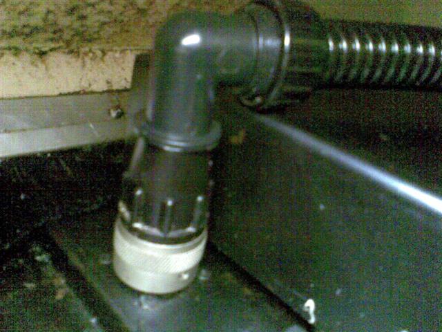

Another question is, how on earth does that plug come apart? Its an RS plug with multi pins that connects the turret to the machine, we wonder if there is a broken wire in there.

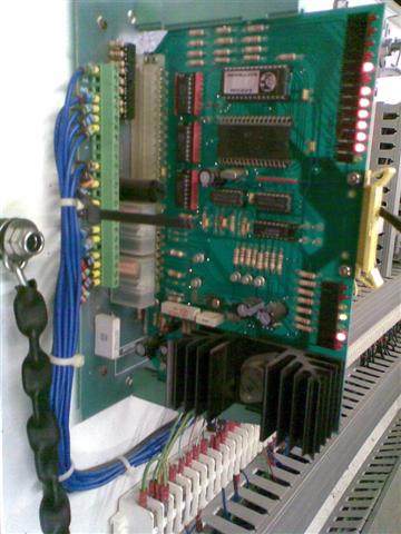

Final thing that is bugging me, is a row of red lights on the PCB card on the machines back panel, the bit that opens and lays down. Panel would be top left if standing in front of the lathe with the back in its closed position. There was one alarm during our attempts to get this running, which said something like power supply, and I wonder if all these red lights are related to my issue.

Tried again tonight, still no joy. Holding the cable, connector pictured, the turret did try to unlock once using the front panel control and green button.. Noticed the turret motor is warm to the touch in less than 5 minutes.
Other photo shows board that is bugging me, its on the far left of the opening back panel.

RS connector: Turn silver ring to unplug and the insert which holds the pins will unscrew from the body of the plug, this will twist the wires though.
It looks like someone has screwed (or glued) the entry to the plug housing and fitted a flexible conduit gland and is going to be difficult to remove without going for it and chopping the wires and re-making the plug.
That board with all the LED's is the official Baruffaldi logic controller card. We didn't use it for very long as it was so expensive, and consequently have no information to hand. Our only hope is that Martin has some info on it.
This board turns a tool number request from the Fanuc controller into the correct sequence. Something along the lines of: brake off, shotpin off, run cw until correct position seen from encoder(or switches), fire shotpin, run ccw, turn on brake, turn off shotpin
Have a good look at the LED's to see if they give any indications as to what they could mean.
