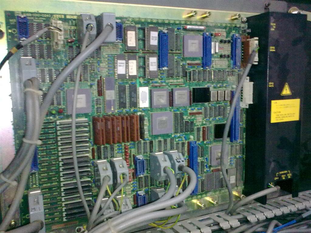

I am a fresh graduate so dun know much abt machines. I recently bought a denford cyclone with fanuc OT Mate control from a machine house in 'as it is' condition. No manual or any sort of document comes with it.
Initially it was giving me 401,414,424 error. I cleaned the drive cards and the mother board and poof....414 and 424 were gone. i think the connections were lose as they sprung up again sometime and i have to press some plugs to make them disappear again.
I also managed to remove 401 by replacing a fuse on the drive card. I have gotten the cards and other electronics checked by an expert and its all working fine.
Problem is that i dun have the parameters of the machine so the turret and the spindle aint wrking. I managed to make the slides work.
I am distressed by the situation and need imediate help. I also codnt find the ID panel on the machine.
Gonna try and attach some photos which might give u some idea of the machine.
Your help will be very warmly appreciated.

- Drive card
- 15122009105.jpg (128.76 KiB) Viewed 25709 times
- 15122009103.jpg (151.62 KiB) Viewed 25709 times
- 15122009102.jpg (49.66 KiB) Viewed 25709 times

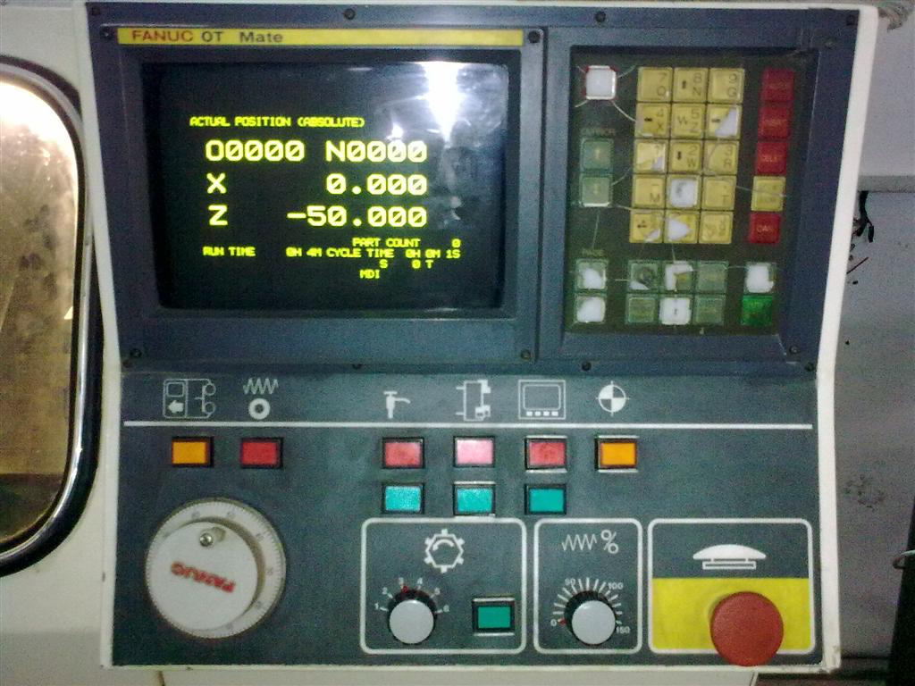

My machines slides are only moving that also when its on the handle mode. Coolant is working. Rest doesnt do anything.
There are no saved programs either in it, as someone told me there shod atleast be one if the parameters are right.
I m requesting someone to plz send me a txt file of the paramters which., after seeing the photos, think that his machine is like or closer to mine.
I forgot to tell the front screen when switched on gives, 0650-01, PMC: 1.0-A.
Dun know if this can help or not.

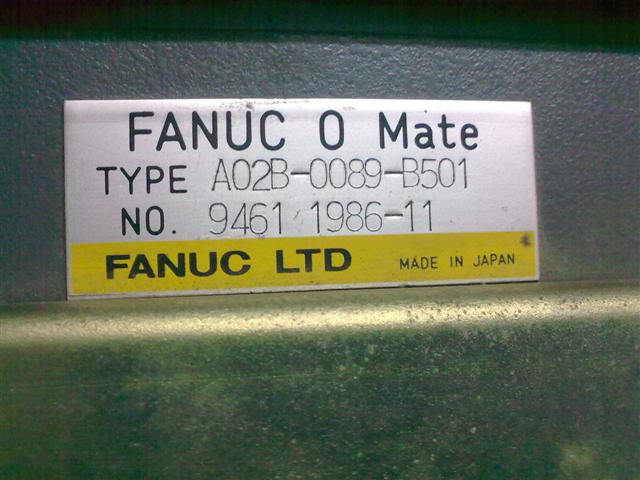

There should be a Machine serial number (not on the Fanuc equipment) - this is needed to find any info Denford may still have.
It would also help if you have any idea who the machine was originally supplied to...

we've had a look through our records and the 1st ever Cyclone Fanuc was made in October 1987.
So, I'm wondering about your machine because the control seems to date from 1986.
Is it definately a Cyclone ? Maybe it was some kind of trial / exhibition machine...
We need as much history and info you can supply
knowing where it was supplied originally would be a great start.

Thankyou for the reply sir.
No, there is no serial number infact there is no ID panel on the machine.
Maybe the earlier place who had it took it off or something.
The machinery house who sold me the machine, i wod try to locate and contact him to know where he got this from in UK.

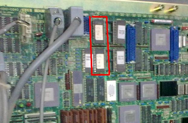

I suggest that if the axes are moving then the parameters are 99% correct (and possibly 100% correct). If teh parameters aor diagnostics were missing then the axes would not operate.
Also, can you let us know what is written on the chips highlited in the attached photo.
- chips.JPG (49.82 KiB) Viewed 25661 times
Re: Cyclone with mutiple problems plz help.
the upper one says ....CYC 1.0 A 012
Lower one says......CYC 1.0 A 011
And abt the parameters being correct, all the cards and everything is fine ihave gotten it checked. I had two different ppl over and they both told me to get the parameters if u want it working.
It sounds like parameters are correct and you need to set Diagnostic bits according to which options you have fitted (like the RH80 turret):

I think this could be one of (if not the) first Cyclone ever built (well not the first - that one fell of the back of a lorry in Hanover).
The PLC EPROM numbering system is CYC V.M R
V = PLC version number
M = machine number
R = PLC revision number
So your "CYC 1.0 A" is machine number 0, revision A
I don't have a solution, but from what I remember (and my memory could be wrong) this machine is unlikely to have any 450 diagnostics (the PLC was written to match the machine) but instead needs individual entries entering in it's timer/counter areas. Without a PLC listing or the documentation that was shipped with the machine this is going to be difficult!
M = machine number
