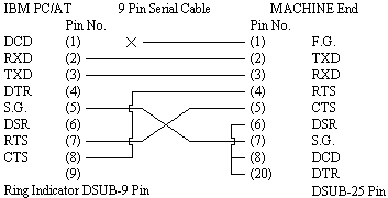

I take it you have used your machines with the 3 phase , did you manually load programs ? or do you use a cad cam system then connect to machine via 232 cable ? I use Mastercam V4 but not sure if I can connect using the 232 cable and download my program direct to machine or whether I need to use a different computer so that I can run the text editor that Denford supply , at the moment my main computer is running Microsoft Windows 7 and will not run a Dos program so would possibly need to use a computer that runs Windows 98 , any info would greatly appreciated

black8898 wrote:Hi Rob
Alan
Hi Alan
I use RS232 cable to upload to the machine, the DNC software I use comes as part of the Cad-CAM software I have, I don`t know if Master CAM have a DNC built in to their software or not, if not then you will need one frome some where!!
Probably the best one around is EasyDNC, don`t know how much it is but here is the link https://www.easydnc.com/
Or, there is a good free one from here https://www.cadem.com/ you have to download the evaluation version of their Cad-CAM software but you get to keep the little DNC software for free for ever!!
Both of these work fine in Windows XP Pro etc so a Windows environment is OK, don`t need to be going looking for an old PC with 98 etc!!!!
See below for RS232 cable connections for a 9 pin at the PC end and the 25 pin on the Denford machine, that`s what mine has anyway!

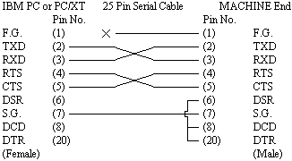

Hi Rob
after what seems like hours I ave found hidden away in Mastercam I have found the software that I need , it has installed with the main program Cimco DNC and Cimco editor software so all that fuss trying to find what I already had , I might do my cable with 25 pins both ends as I have a port on main computer that is not used for anything , still trying to get a phase converter at what I call a sensible price , let you know how things go
Alan
Alan
Hi Alan
Not sure but I would expect a 25 pin socket on your PC to be a printer port?? Not a serial port??
Anyway, here is a diagram for 25 pin to 25 pin cable.
