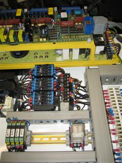

I get the impression, from watching the black thing in the back of the cabinet, that may well be a contactor marked ALRM, that it knows something is wrong before it happens, as the red led comes on before the screen displays alarm, and the turret has not revolved. However, I see your point, and it would explain how on one cycle it did index one station correctly. I wonder if the coolant has found a way in to the rotary switch?

Does the part with the Red LED on ithave a knob & dial on it??
It sounds like it is the voltage sensing relay for the toolpost.
If it is then the toolpost motor has will have a thermistor inside that is fed 24volts DC. When the motor gets hot the voltage drops & the Voltage Sensing Relay should activate & bring up the "turret overheat alarm 1007".
From what I reemember you can turn the dial right down because when the motor heats up the voltage drops away within seconds.
Is the toolpost motor hot when the fault appears?

In this picture, it is the bottom right device with ALRM that the red light comes on before the turret moves back for a tool change. I dont recall any dials on this, but there are on the ones in the centre of the picture.
Alarm comes on before turret does a tool change

I would guess that the Barruffaldi control card may be outputting the fault. It may not be a thermal alarm. Are there any led`s on the control card that light up at this time. When does the alarm activate. You should be able to follow the toolchanger routine from the led`s.
