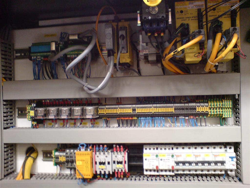

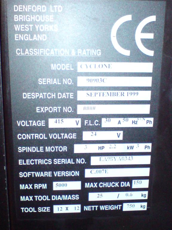

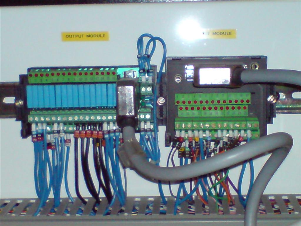

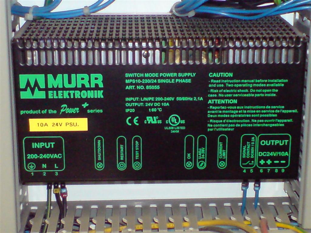

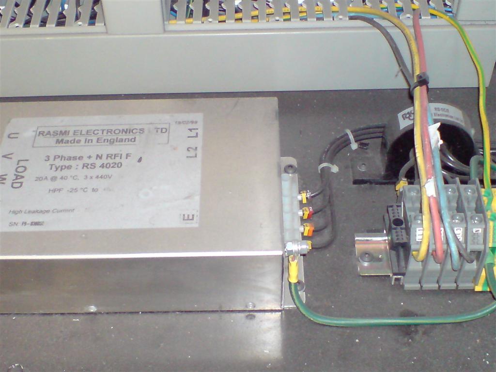

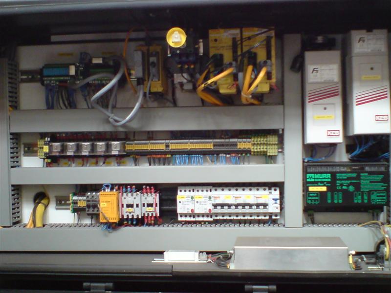

Post by barnfielder » Fri 10 Aug , 2007 12:01 pm
Hello to you, I have uploaded some pictures of the innards of the machine for the purpose of identification before I perform any remedial work. I have included a shot of the name-plate that is on the side of the machine that displays specific details. Hope that these items can assist you in helping me.
Post by Steve » Fri 10 Aug , 2007 12:31 pm
The two KEB units in the top right are inverter drives. The big one runs the spindle the small one the toolpost.
One of the guys in the office should be able to point out the breakers or fuses.
Are there any lights on the inverter?
