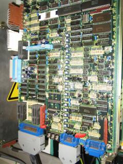

Martin wrote:Can you post a photo of the inside of the transformer box & the electrical connections in the main control box.
It may be that the 24volts dc is 60(0v) & 61(+24v).
The power supply we used back then was a silver chasis with a transformer & pcb mounted on it if that helps to identify it.
Yes, will post photo. thank you.
I have what you describe, but wires 24black & 25black then 61Blue & 68 blue.
I will check for 24vdc on 68
Thank you

Post by Martin » Sat 21 Feb , 2009 22:18 pm
Picture IMG_2831 (WinCE).JPG is of the 24volt psu.
The two blacks are the input which should be 110 volts ac.
The two blues are the output which should be 24 volts dc.
