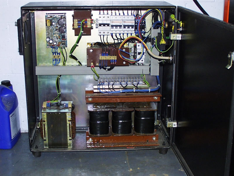

Here is a photo of the inside of my Cyclone power supply box, can you tell us which bit is/isn`t working???
One of the things to check in there, in the top left hand corner is the low volt stabilised power supply, check that for output 12V DC. This supplies the control circuits and if that`s not working then nothing works!
Also in the panel on the rear of the machine is a "Black Box" with a Big Yellow lightening flash on it, that is the main Fanuc power supply and it has some Green fuse holders down near the bottom, check those fuses.

Have checked the fuses on the black box with flash on it and have found the 3.2amp fuse is not working !! so I assume that this could be the problem , where can I get a similar fuse from apart from Denford ?? the main box that you have seny me a picture of is nothing like my one I am going to try and attach a picture of my one , If you can see picture in about the middle you can see a bank of grey coloured switches and at the end of those to the right hand side there is a breaker switch coloured red that is the one that throws in when machine is turned on and then out within a couple of seconds , one last thing is there a temporary way of replacing the fuse that has gone to see if that is my problem ??

The fuse that has blown is not in the main box in the picture but in the upper cabinet , the box it comes from is the power supply box that supplies the Fanuc unit and the fuse is 3.2 amps
