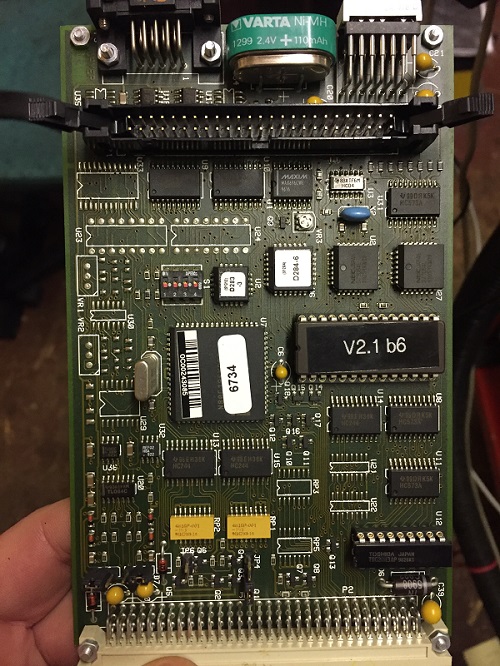

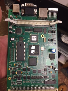

Hello
I have got control card NextMove ST from denford Triack and I'd like to mount the card to my cyclone E. Is this possible?
NextMove ST
This is old control card
Re: NextMove ST control card to Cyclone E
Post by Martin » Mon 19 Dec , 2016 8:48 am
Yes it should be straight forward. I think you just need to change the machine type to CycloneStepperNS in VRTurning.
