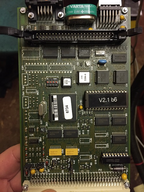

TDIPower
Posts: 613
Re: Cyclone cut thread problem.
Post by TDIPower » Sun 11 Dec , 2016 0:28 am
I have a DOS based starturn 5, I bought quickturn 2d Design knowing the screw output wouldn't work but for the benefit of being able to design stuff and get the G code, a bonus I found was that each different section of the outputted code starts with a description. I have not needed to do any thread work yet but have the older lathe design software so can, when needed, produce the G code in that and copy/paste it into the required section. Or I hope be able to learn how to just write it my self (spend an evening on a text editor writing codes for standard threads then just change the lengths and insert when required. It would be nice to just upgrade the electronics to a later version that supports VR turning.
