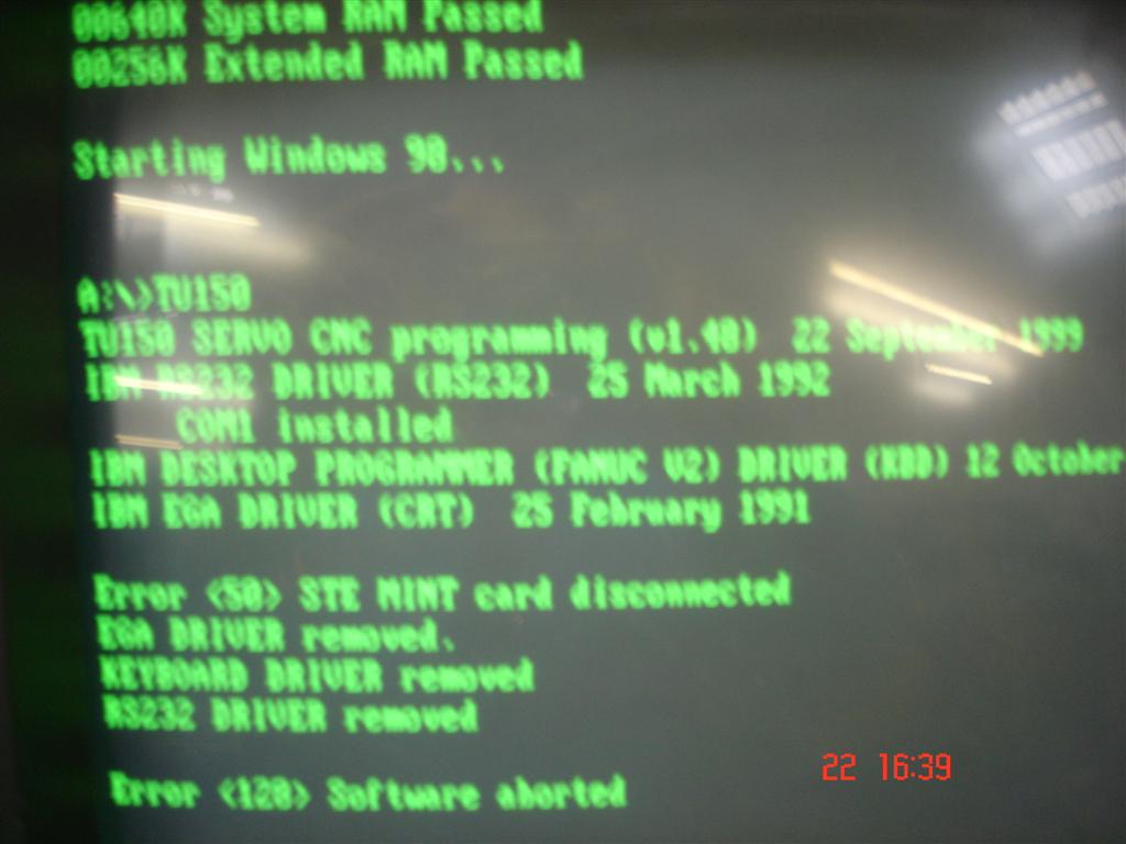

HI AGAIN,
HAVE TRIED ALLSORTS TO GET THIS UP & RUNNING TO NO AVAIL.
IT IS BOOTING UP (STARTING WIN 98)
BUT IT GETS TO A POINT AND ON THE SCREEN IS THE FOLLOWING
ERROR (50) STE MINT CARD DISCONNECTED
EGA DRIVER REMOVED
KEYBOARD DRIVER REMOVED
RS232 DRIVER REMOVED
ERROR (128) SOFTWARE ABORTED
I HAVE TRIED UNPLUGGING THE EURO CARD (MINT CARD) AND RE-INSERTING BUT IT STILL COMES BACK TO THE SAME THING
I AM STILL PADDLING UP THE CREEK !!!
CAN ANYONE HELP , HAS ANYONE GOT SPARES OR IS THERE AN ENGINEER WHO IS FAMILIAR WITH THIS MACHINE
AND PROBLEMS

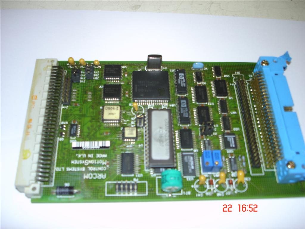

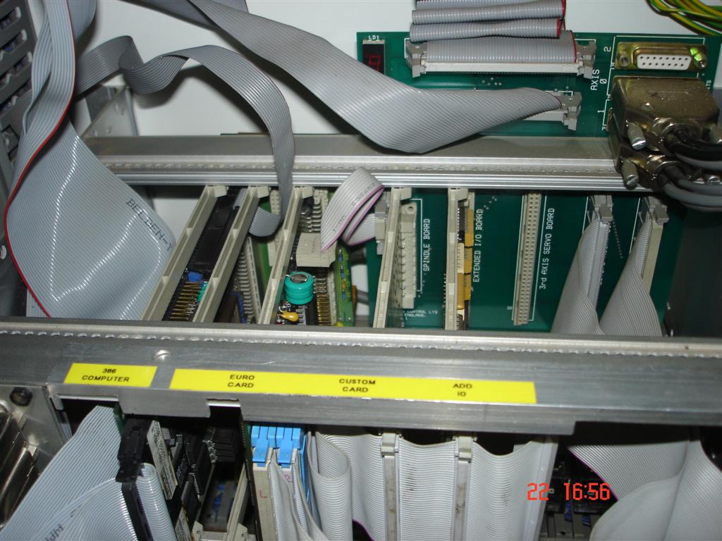

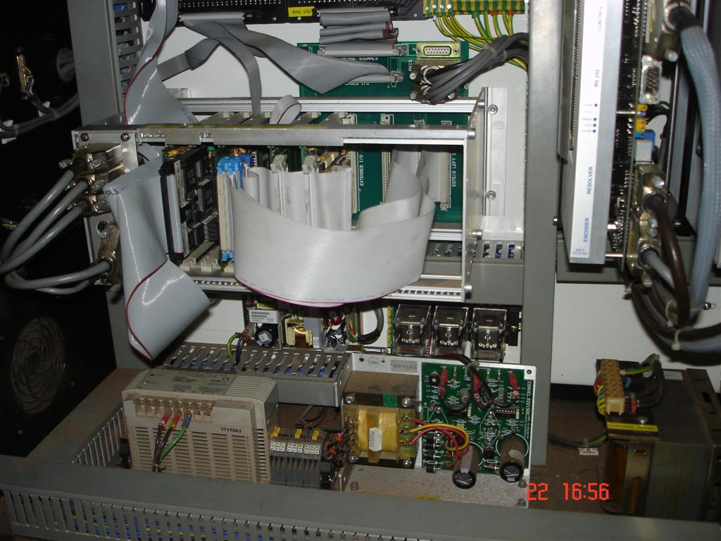

Can you also post photos of the card rack and close-ups of the cards - there may be something missing

enclosed are pics of boards in and out
- DSC00147.JPG (78.67 KiB) Viewed 17696 times
- DSC00164.JPG (99.14 KiB) Viewed 17696 times
- DSC00171.JPG (134.93 KiB) Viewed 17696 times
- DSC00172.JPG (132.1 KiB) Viewed 17696 times

Does LD1 on the backplane inluminate?
Re: mint card
no it never has.
Re: mint card
The seven segment LED (LD1) on the backplane should display a "L" when the ste motion control card is powered up. Can you check that the small (ten pin I think ) ribbon cable is pluged in to the ste motion control card & the back plane. If it is & it does not function then you may need to look at the computer power supply. It may be worth trying the motion control in the spare slot to the left if you can.

we can`t fit the board into the spare slot as the computer card ribbon bracket fouls on the motion card

How about removing the pc card to gain acces?
If the STE Motion Control card does not power up then the software will trip out.
