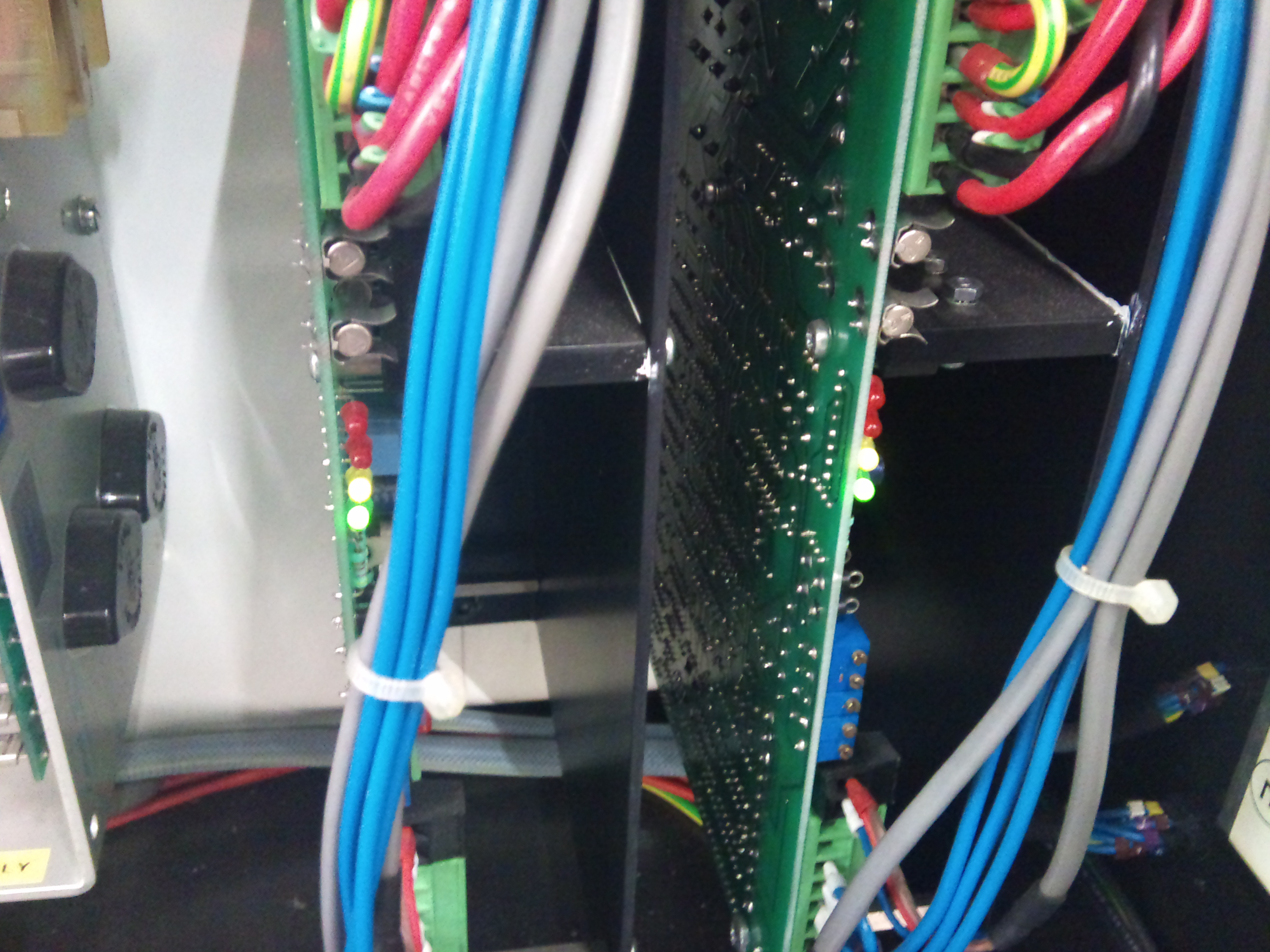

Have checked
F1 - F2 on INPUT UNIT
F1, F6 - F9 between TRUNKING E and D
F12 - F13 on POWER UNIT
During bootup:
The SO and SI LED's illumiate on the OT-A Control board
The XER and ZER LED's flash on, then off again!
The SI LED switches off leaving just the SO LED on.
Have located the drive boards (pic) and only 1 amber LED is shown operating on each board!
Have check the 3 fuses built into each drive board.. all ok!
During bootup:
- 2010-12-14 16.22.20.jpg (2.54 MiB) Viewed 19477 times
