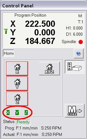

X and Y will home. Z will jog. It seems like the datum switch might be bad. When I move x and y from home, the green marker next to x and y on the vr software disappears. When I jog z from home, the software still indicates that the Z axis is home.

If any of the green surround axis letters are showing when you first connect to the machine with the VR Milling ver 5 software, then there is either a problem with the relevant datum switch, datum switch wiring or input on the control board.
- X YZ On datum switch.JPG (27.21 KiB) Viewed 18845 times
