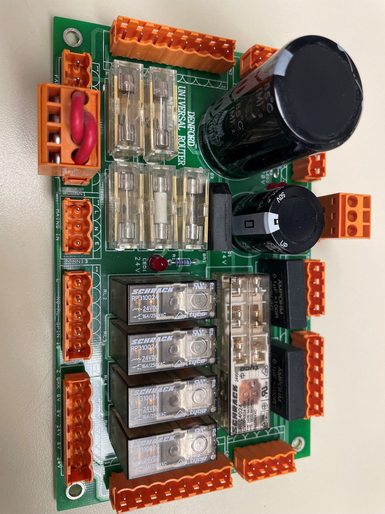

Did you ever solve this issue? I have the same problem and looking for some guidance. The z-axis makes a shutter noise and then the z-axis is off in the program which causes the bit to run into the F1 jig I am using. I have attached a picture showing burnt contacts in the Schrack SR6C4024 6 connection relay. Can this relay be the source of my problem? I will consistently have a z axis problem after less than a minute of running a program. I have ordered the relay but am wondering if my motor is the cause. I will measure resistance and check wires to make sure nothing else is at play.....
