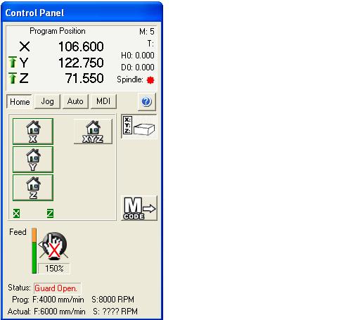

Can you download the lattest version of VR Milling 5 and run that.
Next time you have the homing problem abort the procedure with the Esc key.
Then with the software still in the Home mode press each home switch in turn. The axis is displayed in green at the bottom of the positional display window when the switch is actuated if the switch is functioning.
If the switch contacts are jammed open with dust the axis letter will be displayed constantly (and the axis will move away from the switch slowley when you send it home).
The best way to clean the switch is to put a vacuum nozel up to the switch then manually operate the switch.
If you just use an air line or vacuum without operating the switch you will not clear the dust as it is trapped between the contacts.

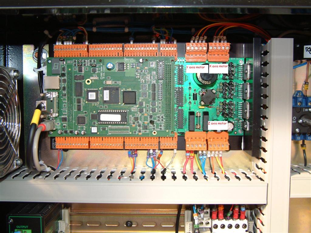

- Axes Diagnostic.JPG (28 KiB) Viewed 35679 times
- bradders
- Posts: 1251
Re: Compact 1000 not homing
If the read outs are incrementing when you try to hame then it may be that the the fuse that on the Nextstep bottom board has blown, it is shown to the Left of the "Z AXIS MOTOR" inset.

- next STEP motor.JPG (143.34 KiB) Viewed 35682 times

Morning all, 8am Sydney time here. Re-read what I wrote last night, especially that last sentence, wouldn't have thought that a glass of wine would have hit me that badly.
Will be in at school later today, I'm assuming the axis fuse you refered to is the single fuse on the board with the three connections to the axis motors. Did test this (continuity tester on multimeter), proved to be OK. Will try to have a look at the e-stop switch.
Yes the drive fuse is the one pictured. It should be a 6.3amp semi delay 20mm fuse.
