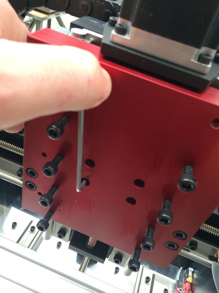

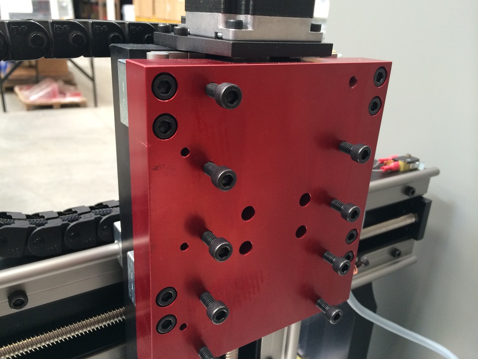

1.Remove the motor plate (picture 1). It should lift off once the screws are loose. (picture 2).

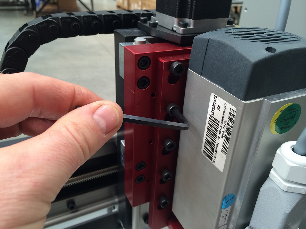

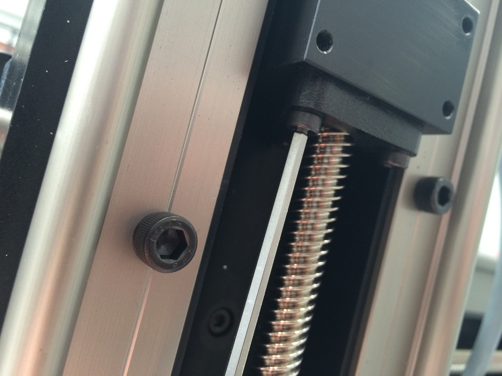

2. Remove the 4 screws holding the block & drop the slide way down (picture 3). This should allow you to locate the 3 screws that have dropped out.(picture 4) At this point you need to leave them slightly loose to allow the block to move.
3. Assemble in reverse order & lift the Z axis to the top of its travel then tighten the 3 screws.
