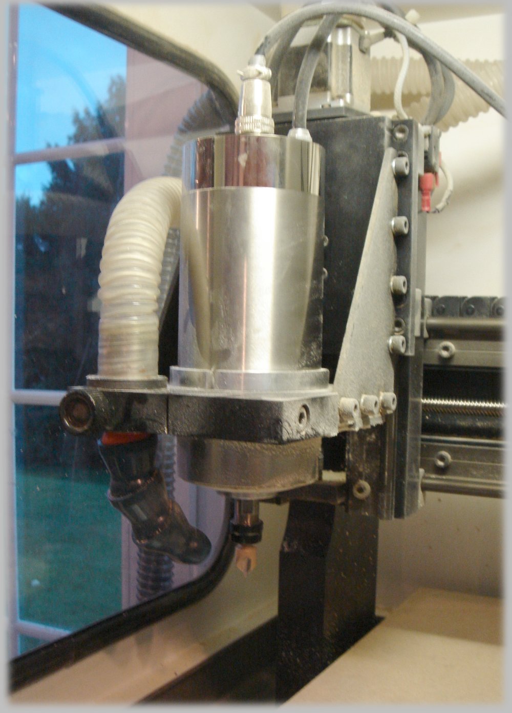

I got this one from eBay with inverter - https://www.ebay.co.uk/itm/250952849906? ... 1439.l2649
I had a pump and cooler unit so I got this one to avoid more noise and to allow the vacuum collection to work better.
I could have used their Air cooled version. Very accurate ER11 (came with 4 collets) upto 7mm
A simple adaptor ring allowed it to fit into the same mounting hole as the Porter Cable.
Inverter fits into the control cabinet (Above the mains cable input) and is powered on at the same time as machine.
Simple control connections from board 0-10V to inverter. I even managed to connect an overide Motor speed pot.
BUT the power to Spindle On/Off from board was tricky, although there is 24v to power the onboard motor relay there is not enough to power 2 so I just used the 240V out, to the old motor into a 24V PSU (loads around) which powered a relay switch connected to the inverter for Forward on/off to the spindle. It is very simple and quick to change it back to the original motor.
All works fine, much more accurate and it can cut soft metal.
Yes it is so quiet that a mark is needed on the spindle head to show it is rotating.
I attach a pic of the mounted spindle

Re: Denford 4th Axis can only rotate from 0 to 359.99 deg?
That's an amazing price for that setup!
