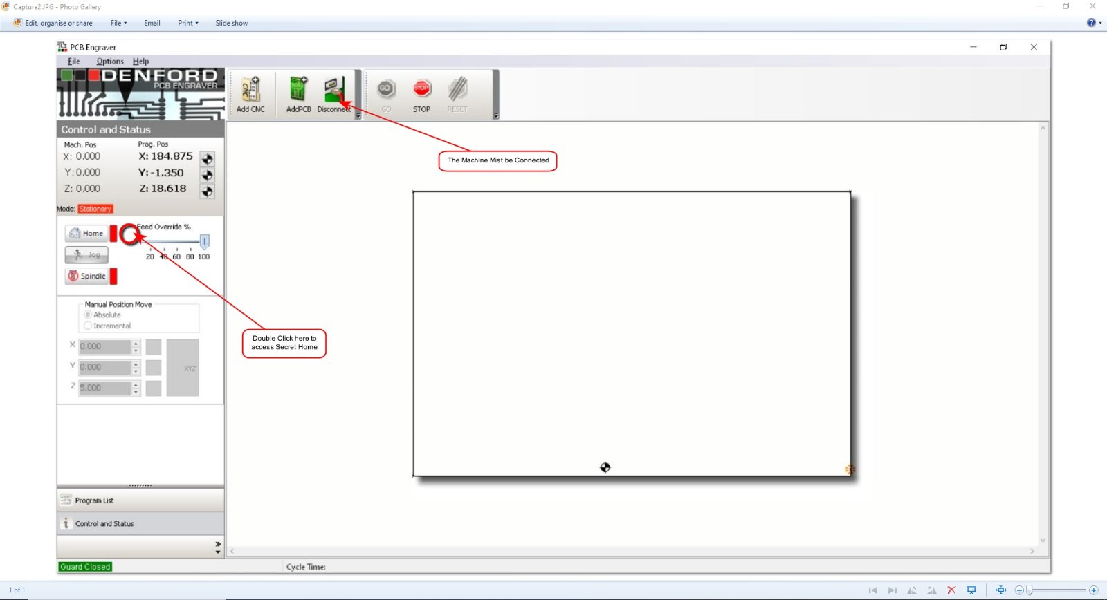

If you are having problems homing a PCB Engraver it could be that somthing is preventing an axis reaching a home switch or there could be an issue with Sust in the swich.
By clicking the secret home button the machine thinks it has completed the homing routine in the position it is currently in and will allow you to enter Jog Mode and then you could jog the axes clear of the obstruction.
First connect to the machine.
Then double click to the Right of the home button.
The Jog mode should then light up and can be accessed.
PCB Secret Home.jpg (89.5 KiB) Viewed 15578 times
