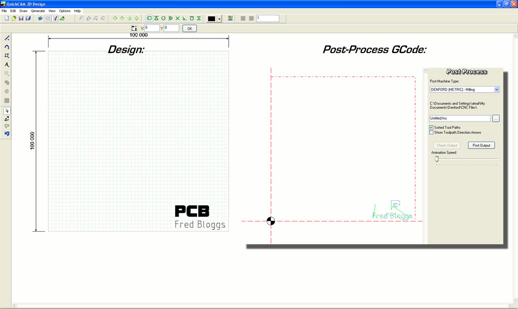

Re: Engraving Lettering
I think you will have also got a copy of QuickCAM 2D Design ?
If so, you can easily create a template drawing for single-line font engraving and post a G-Code file which can be loaded into the PCB engraver.
- QuickCAM-Engraving.jpg (60.58 KiB) Viewed 15921 times
