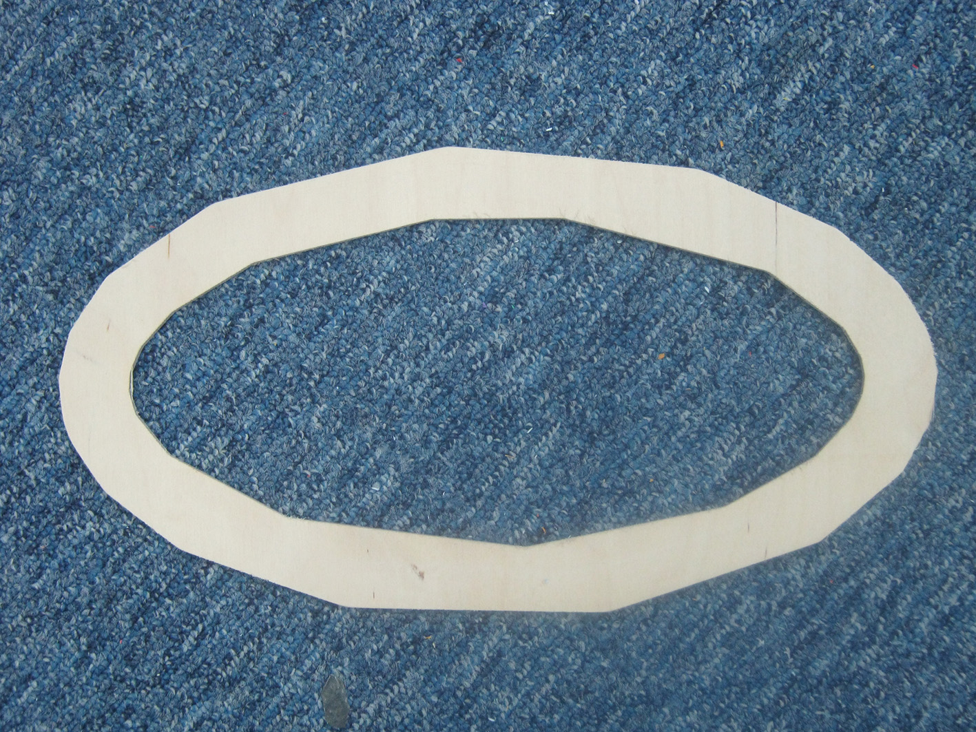

We have a student who needs to machine a series of ovals on the Microrouter to construct a laminated box.
He has drawn them up in Techsoft 2D Design V2 version 2.10 and they appeared on screen as intended, and also cut out cleanly and to the correct size when he did a test run in thin card on the laser.
When we save as a dxf however and import into the Microrouter running VR Milling version 5.54.0.630 the drawing import cam page shows the design as whilst still being basically the correct shape, it is made up of a series of straight lines and not the smooth curves as originally drawn, and this new, incorrect tool path is confirmed in the next stages when the outer contour is selected, simulated and machined, this problem also occurs in another design involving a circle.
We have tried completely redrawing again with the same results, I am not sure what the “use arc command” is supposed to do when exporting from Techsoft 2D Design as a dxf, but it doesn’t seem to make any difference in this case whether it is used or not.
We tried taking a copy the same drawing and using the “Alter the size of the selected objects” command in the 2D Design toolbox, reduced its size to enable it to fit a piece of 160mm x 90mm HIPS, and then saved this as a dxf before importing it into the Triac and where it both simulated and machined perfectly.
I understand that if the drawing size is reduced, then any errors will also decrease proportionally, but the Triac version appears perfect, with no distinguishable defects at all.
Both the machines are networked and running windows 7 service pack 1, the only difference I can think of is the Triac is using a different version of VR Milling, as it currently has version 5.49.0.613 installed.
Is there a setting somewhere that controls the resolution when converting to G-code, does anyone know of any conflict with our version of 2D Design and the Microrouters version of VR Milling or are we missing an obvious point, because we have never had a problem like this before.

Hi, thanks for the reply,
Here are the a couple of screen shots, dxf and a picture of the machined result, I tried to add the Techsoft 2D Design file but the forum won't allow the dtd extension.

- Oval For Box Machined.jpg (663.77 KiB) Viewed 47517 times
Re: Circles/arcs
Hi, I have tried opening the DXF in various packages and it apears to be OK. I had V 5.53 on my computer which worked fine. Have upgraded to 5.54 and have the same result as you do.
I will forward this to our software engineer and we will get it fixed and post a new version.
Short term either go back to your previous version or import the DXF into QuickCAM 2D and post process in that package.
Re: Circles/arcs
OK, thanks for the quick response; your help is very much appreciated,
Kev
Kev
Re: Circles/arcs
Hi. There is a new version of VR Milling available on the software download site at https://website.denford.ltd.uk/index.php ... -downloads. This version number is 5.55. The curves on loaded DXF files are smoothed off as expected. Can you please download and install this new version and see if that works better for you?
