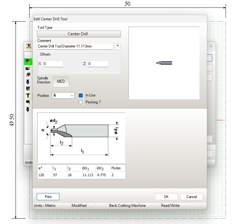

The problem is down to my defining a centre drill as having a major diameter of 7/16", 0.4375" or 11.113mm.
This looks perfectly legitimate to me. QT2DD seems to be working on the major diameter rather than the minor diameter, hence the error.

- Mirac Tooling.jpg (62.02 KiB) Viewed 3548 times

I managed to get rid of the drilling errors by fitting a 6mm centre drill in place of the 11.1mm diameter one fitted and editing the tooling file accordingly. I believe Miracs came with 5mm centre drills? I had use a 6mm one as the only spare DB25 holders I have for use with my ATC have 6mm bores.
