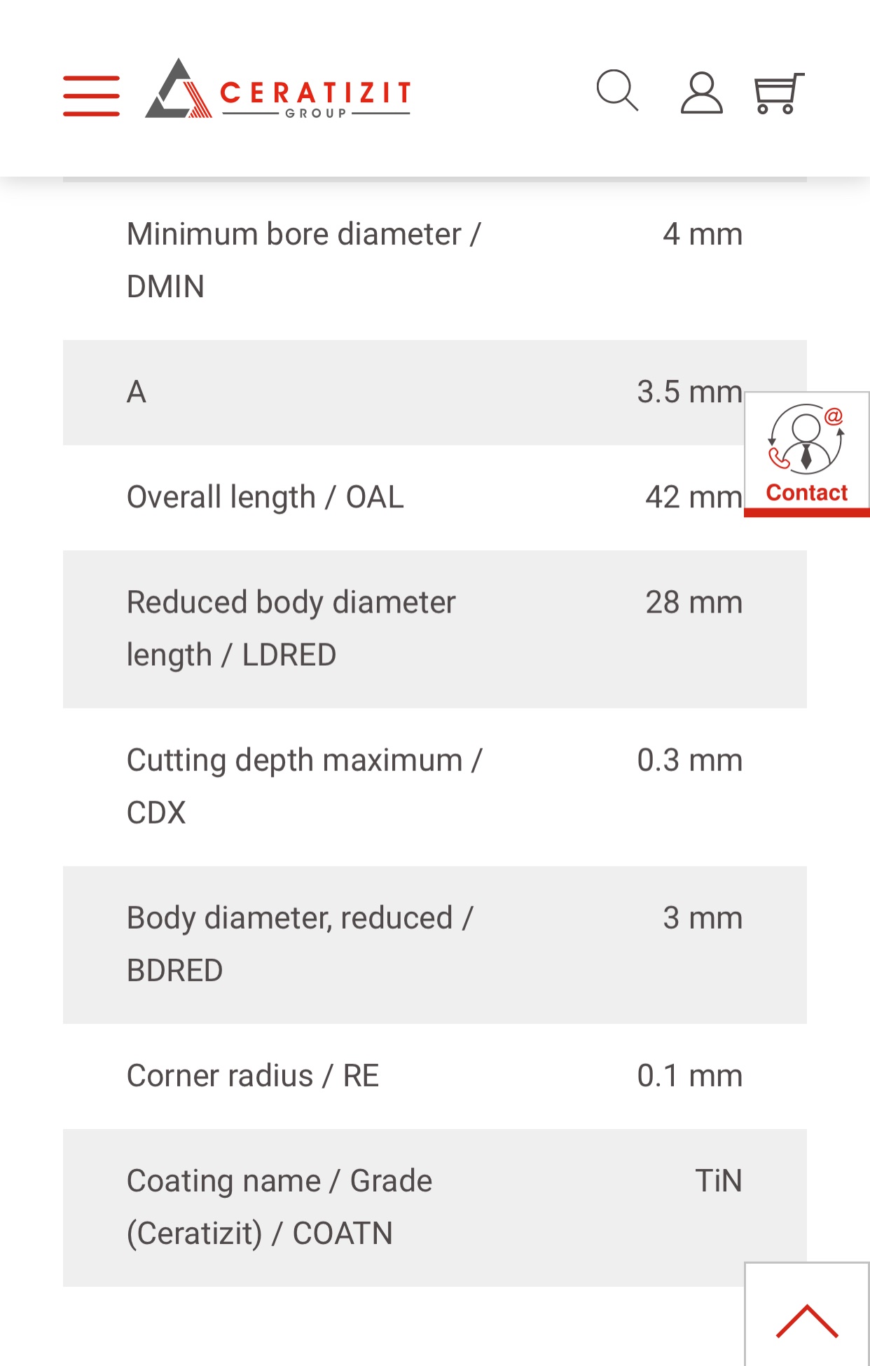

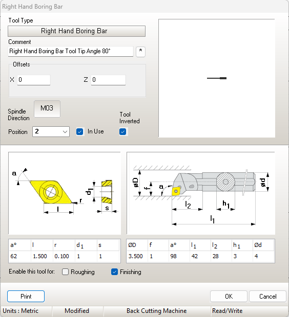

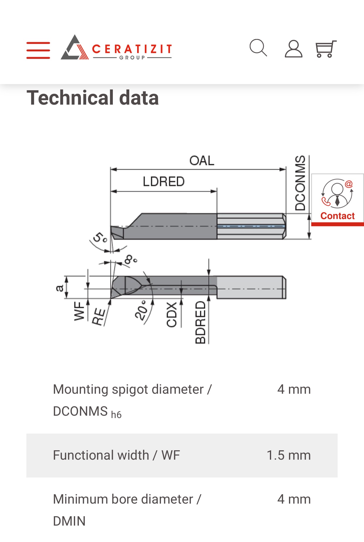

This is the data I used for the tool. Can’t take a picture of the data on the PC as it’s down awaiting a new GPU tomorrow.

ok no problem. I entered the data from the tool into QuickTurn2D, as you stated it cannot go down into the smaller bores.
What I did was reduce the value of f to 1 (WF on your datasheet). Theoretically this should just reduce the size of the cutting face. This change does allow the tool to now bore down to 5mm.
I would also reduce the cut depth in the materials library to 0.3mm (currently 0.4 and 0.5mm Fine / Rough).
Watch the machine very carefully on the first cut to ensure it doesn't do something unexpected though.

Just worked out that even though it was disabled the CAM was trying to use the original 8mm boring bar
so that tool data was deleted and now its using the carbide boring bar. I also made the changes you did and it has managed a successful simulation.
