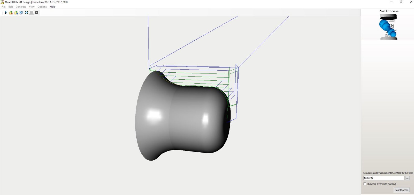

Hi I tried this with version 1.33.7233.57000 and it all seemed to work OK.
Other than the bar being 34mm I could not see any issues.
What Lathe do you have? Note the max parting diameter on a Turn270 is 25mm Turn 370PRO has 35mm.

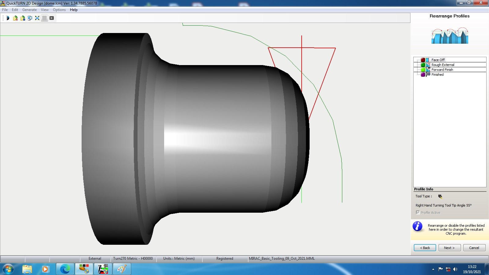

I'm using version 1.34.7885.56078. I've changed the Machine Tooling file to reflect the fact that my RH turning tool has a tip angle of 55 degrees rather than the default 65 degrees.
Machine is a Mirac which as far as I can see is doing exactly what the Gcode is telling it to. I didn't specify parting off or use of the parting off tool, just the RH turning tool for roughing and finishing.

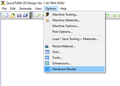

Hi Max. In version 1.34, from the main screen, can you select Options and then make sure that Hardware Render is definitely selected. If it was off before then does this make a difference to you?

Did you add the red arrow to the image or has that been created as part of the plan?
If I then have just a single tool of RH turning, the plan does perform roughing cuts correctly, whether the angle is 55 or 66.

There have been a couple of changes in the new version. Check that you have hardware render selected and the part then renders correctly.

What does "Hardware Render" mean by the way?

Hardware render uses the basic windows graphics card as oposed to advanced graphic driver.

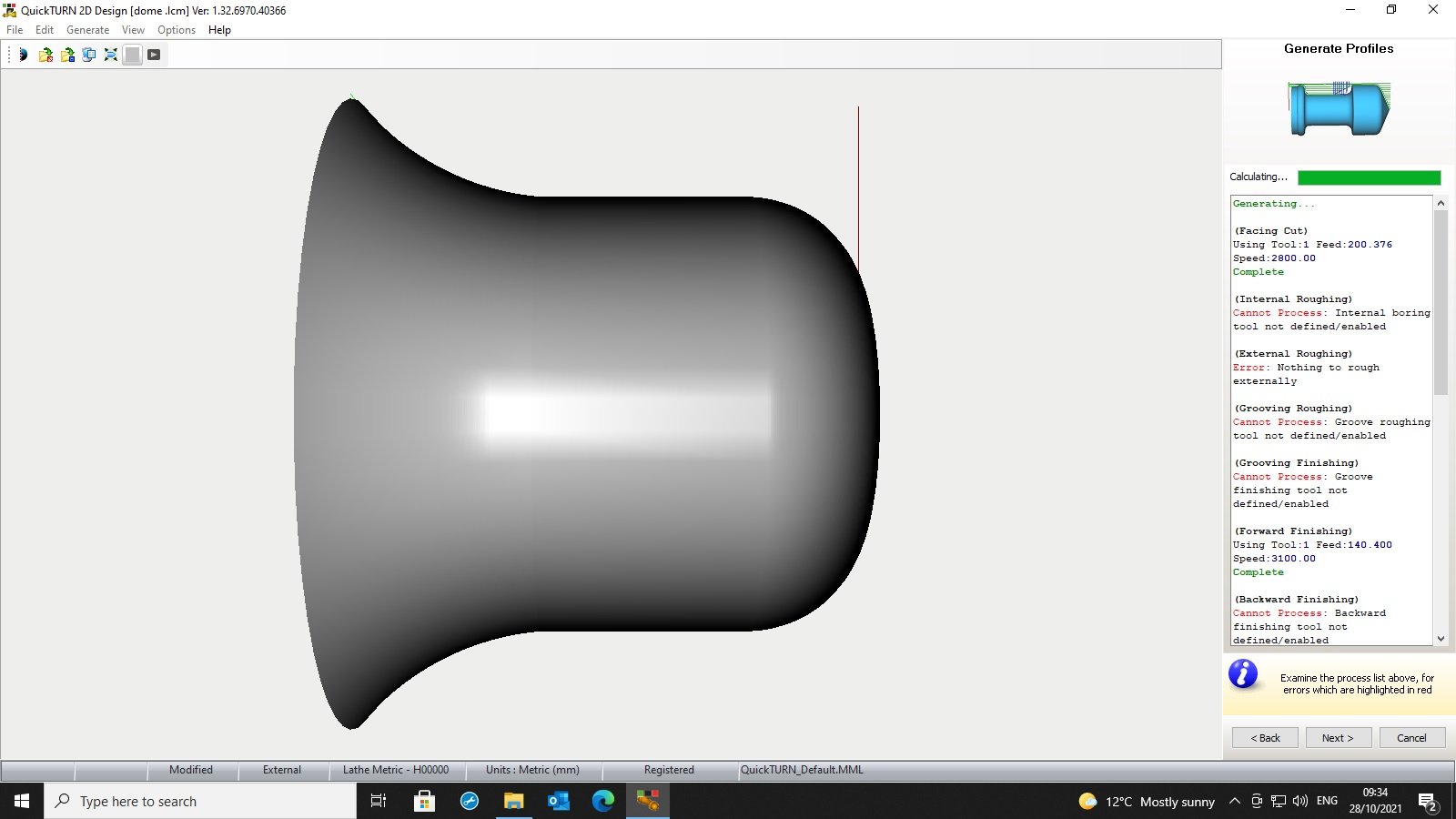

Results were much the same as before. Change the tool angle to 55 degrees and no roughing cuts are generated. I see this error message:-
(External Roughing)
Error: Nothing to rough
externally
See attached screenshot.
The tool angle is the only thing I've changed. All other tool parameters remain as in the default file. The image of the tool looks correct.
I found that things worked correctly if the tool angle was changed to 64 degrees or 63 degrees, but not if the angle is set to 62 degrees.
I also tried it on version 1.32.6970.40366 with similar results. This version produces a log file which I've attached.
I've tried in on Windows 7 and Windows 10 systems and they both behave in the same manner.

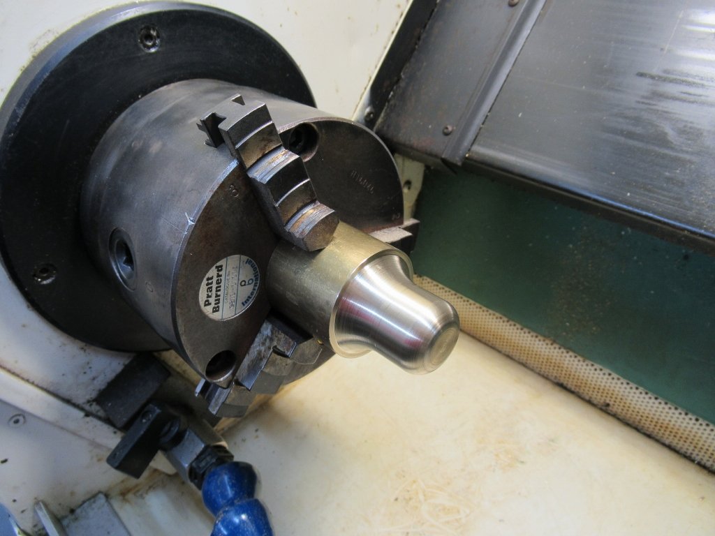

Thanks for all your help Steve.
The easiest work round is to specify the tool angle as the default setting of 65 deg even though a 55 deg tool is being used. It makes no difference on this type of profile.
