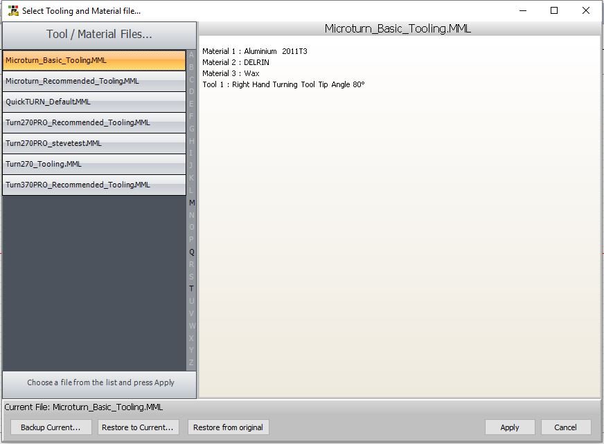

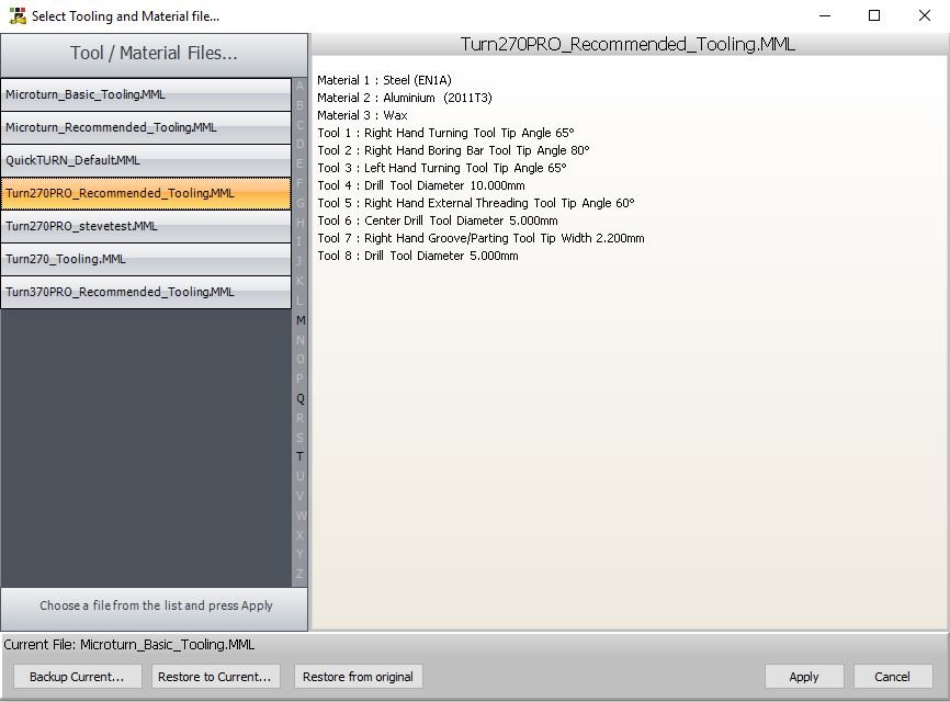

The second problem you mention is that Quick Turn 2 D Design is not using the tool library from your machine.
This is normal as the tool library is not linked. You have to select the correct tool and material data within QuickTURN 2D Design.
This is simple to do and allows any computer to be used to design parts to be taken to the lathe.
By default the MicroTurn basic tooling is selected in Quickturn 2D Design. You must select the correct tooling when you install the software.

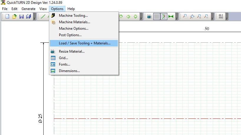

To do this open the QuickTurn software.
Select the Options Menu
Select Load / Save Materials and tooling
Select the machine you want from the list in your case Turn 270PRO Recommended tooling

I simply don't have the option in QuickTURN to select the Turn270PRO_Recommended_Tooling.MML profiles.
There is only the Microturn_Basic_Tooling.MML
No Issues with loading the tool offsets in VR Turn.
Is this something to do with the install of Quickturn or something else? Have re-installed Quickturn to see if there was an option to select the Turn270 Pro, and am sure I chose this machine when installing VRTurn.
