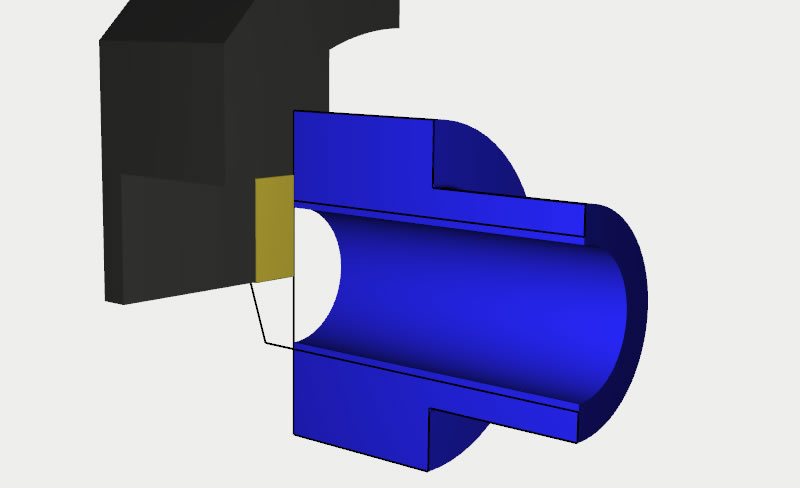

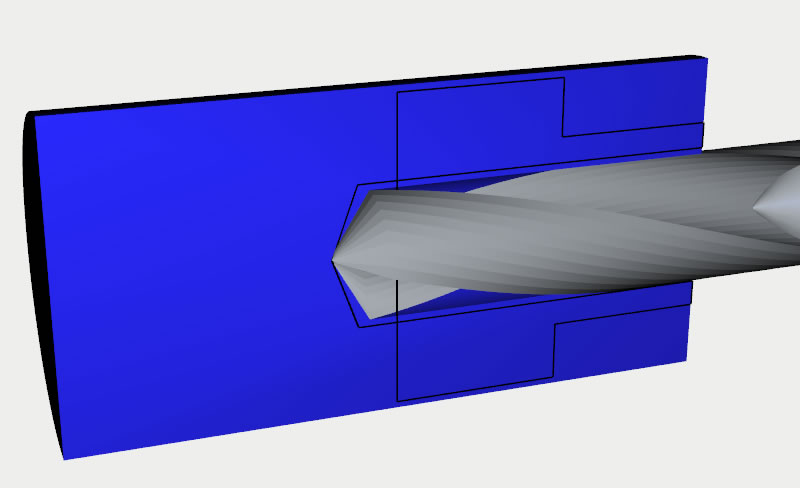

the problem im experiencing is that although in the modelling using QD2D it appears fine, i can create the bore all the way through to the part off, however when i come post process, the tip of the drill bit pierces the partoff point, however the 120 degrees of the drill angle doesnt, like that in the picture below
Can anyone please tell me if there is any way to achieve the desired result.

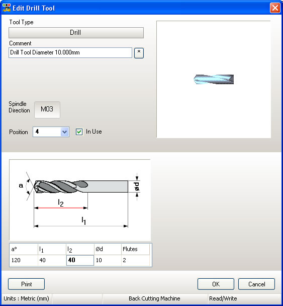

It's probably the setting of the drill which is stopping it going any further.
Check if this value is set shorter than the drill can actually go to:

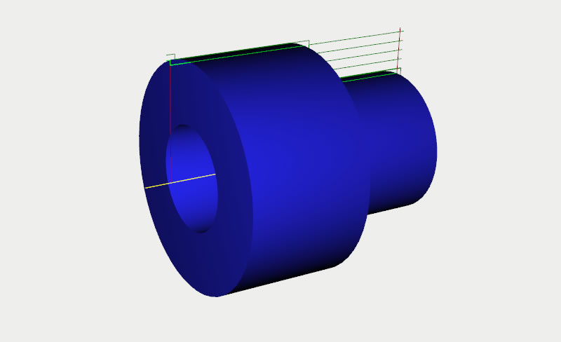

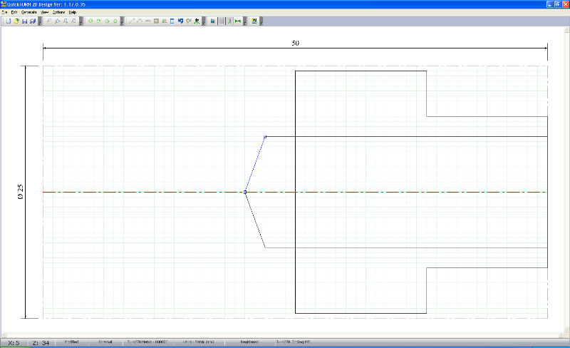

You can see from these images that I've drawn something similar and extended the internal profile to go past the end of the external:
