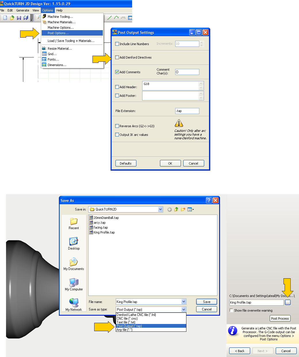

from version 1.15 onward, options have been added to change to format of the cnc output file generated by QuickTurn 2D.
This is so the programs will load and work on other CNC machines (eg, Mach 3 controls)
For Mach output, make the changes shown below...
Turn off Denford directives and check the other options are as shown.
When you come to the postprocess wizard, click the browse button and make sure the Save As filetype is set to Post Output.
