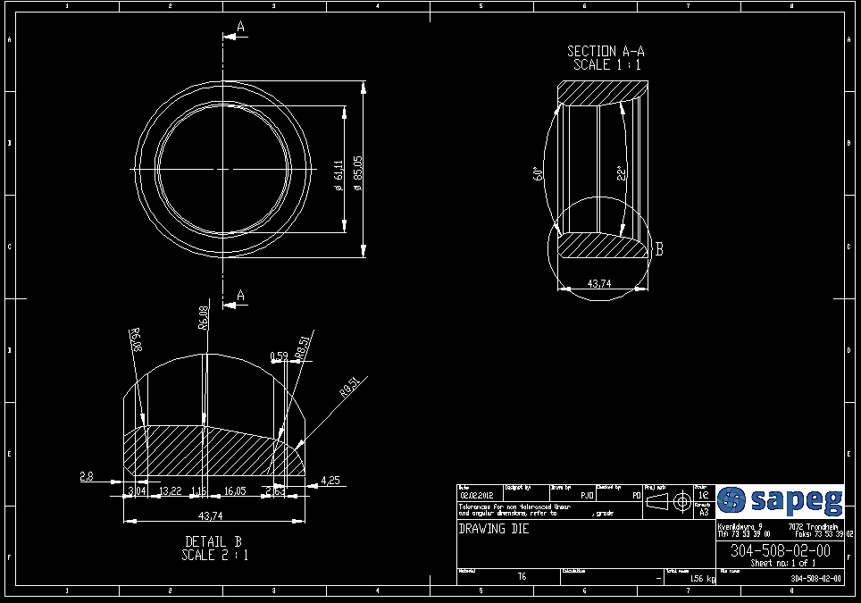

I can always start with facing on the item.
- 304-508-02-00.DXF
- I dont get all the profiles correct on this DXF file.
- (1.84 MiB) Downloaded 1230 times

Re: Internal Turning
Having looked at the DXF file you have exported the full drawing where all that is needed is the profile of the actual part.
QuickTURN 2D Design will not machine internals with undercuts.
Also the DXF import to the software is part of the CAD engine (that is a 3rd party product) and while we can make some changes to it there are issues that we cannot resolve.
