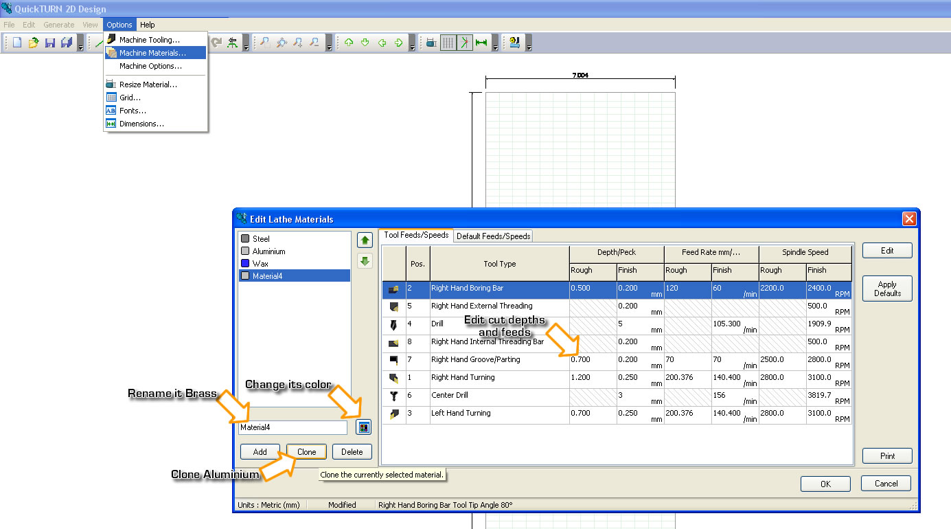

Is it possible to add additional material to the options when using the wizard.
We would like to use brass.
Re: QuickTURN 2D Material
Post by Denford Admin » Thu 02 Jul , 2009 14:00 pm
Its easy to add more materials (see image).
Just pick an existing one close to the one you want to create (eg aluminium), Clone it, Rename it and set its colour
I'd also recommend downloading latest version (currently v1.3) because there have been issues with tools having corrupt materials settings.
