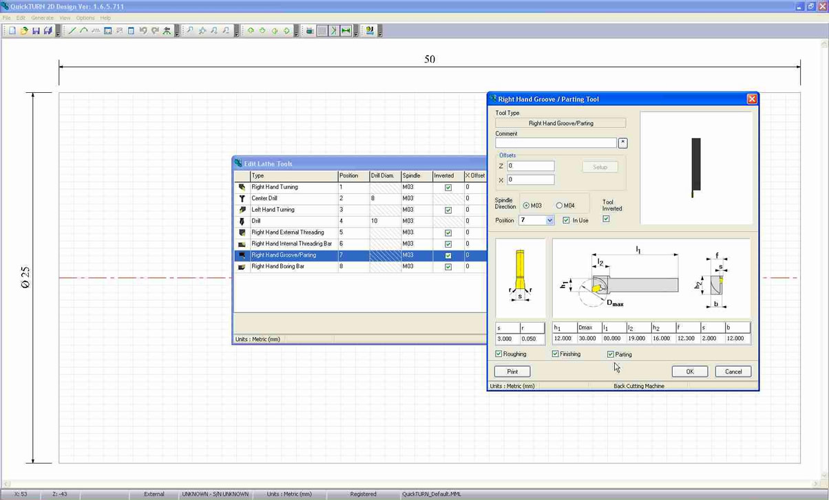

Post by Steve » Fri 13 Nov , 2009 12:02 pm
Go to the Options page
Machine tooling
Highlight the parting tool and click edit.
Make sure the check box is ticked for parting
I will check with Admin why this is not the default setting.
