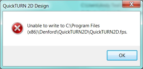

Unable to write to quickturn2d.fps
Posts: 3651
Post by Denford Admin » Wed 16 May , 2012 11:25 am
You may see this message on windows 7 or vista machines when closing down quickturn2d.
It is a bug which will be fixed in v1.13 or higher.
Normally only seen if quickturn2d.ini is deleted and only appears the 1st time the software runs after that.
