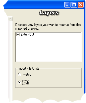

too small
This could be because Coreldraw presumes everyone uses imperial units, and is exporting the DXF in inches, not mm.
Change the import units to Inch on the first wizard screen...

Set import units to Inch, if the exporting program (eg Coreldraw) assumes imperial units

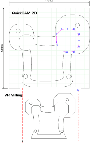

I can see your problem...
The file seems to be importing differently in VR Milling, than in our other CAM product QuickCAM 2D (see screenshots)
Can you confirm that the shape is correct in QuickCAM 2D ?
We can then look at the VR Milling spline import and fix it.

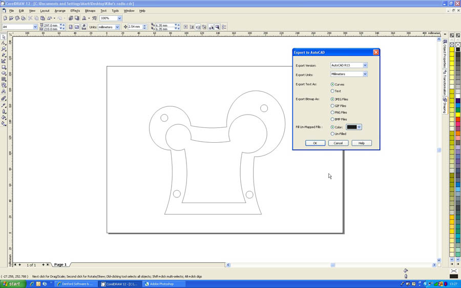

This is what the original design in Corel looks like, i've also included the export settings that I'm using. Unfortunately we don't have Quickcam 2D, everything else except that.

Even though QuickCAM is doing a better job, it looks like its still not converting the splines / curves as intended - like I said, its down to how corel is outputting the curve control points, and how our s/w is interpreting them.

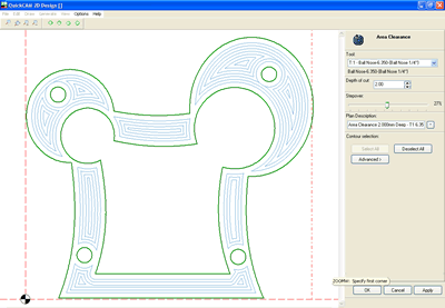

I think we are struggling a bit against Coreldraw and its insistance on outputting DXF in imperial units - I also suspect that V12 is exporting different to v10, as I get better results with v10 :?
The only way I can get to create a toolpath from your shape, is by running QuickCAM 2D, and using the clipboard to copy and paste the design from Coreldraw, into QuickCAM 2D (see pics - I have created an inside contour toolpath on your shape)
Shape pasted into quickCAM 2d, and an offset path created

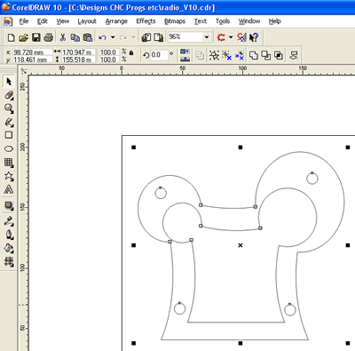

Your shape loaded into Coreldraw 10. Copy
