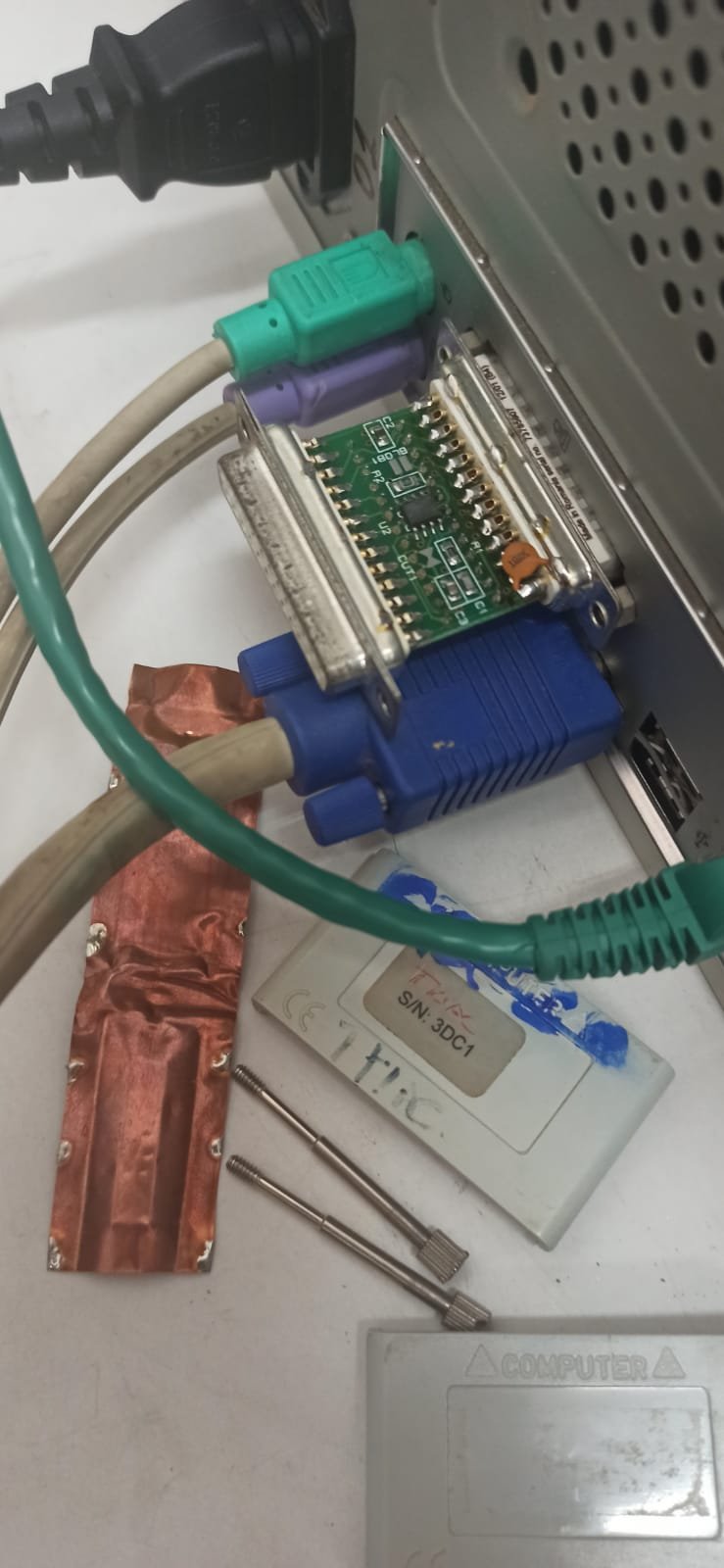

Hello all,
Im just here to notify about what happend in my institution, im an intern from UTFPR-BR, we`ve got an old turning and milling machine that i didn`t even got the right model to register here, but its old. The turning machine was functioning ok but for something like a decade or more the milling machine has stopped working for some reason that nobody could resolve.
We have the CD-ROM with the VR CNC Milling instalation and a floppy disk that we dont think that has the original files preserved anymore. But a whole imagem from the whole windows OS that has been saved since the days it used to work.
The problem was that we had this error "Dongle not Found", and after many struggle i had the idea of opening it to see if somehow the phisical components were damaged.
under the housing, a thin copper tape insulated the entire device, with solder points that made the ground. But this strip looked like it had been forced, crumpled in, and the solder points had cracks. We decided to remove this copper part and, amazingly, the dongle was recognized by the software again.
So, for anyone having this problem, try to see if there is something like the image inside your dongle, maybe removing the copper tire helps.
ty.
ty.
