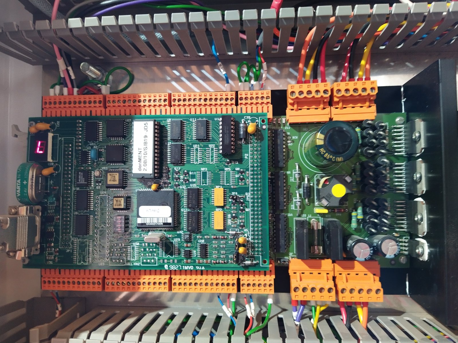

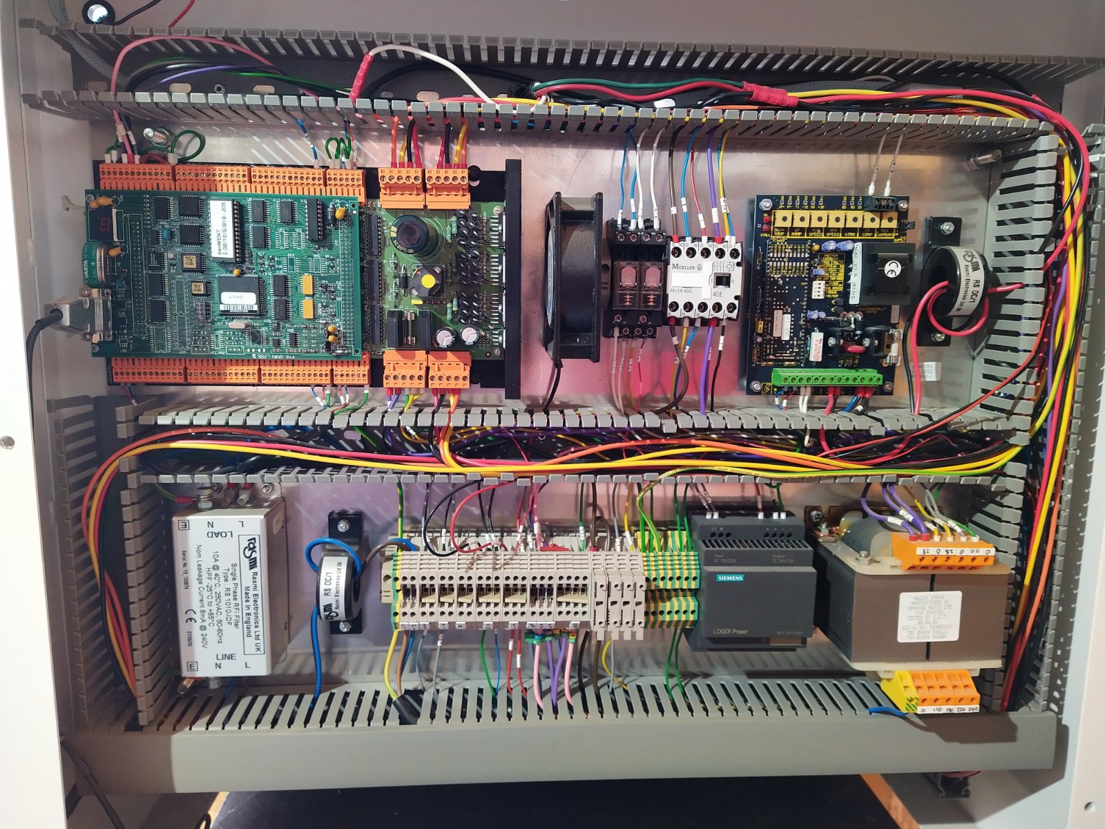

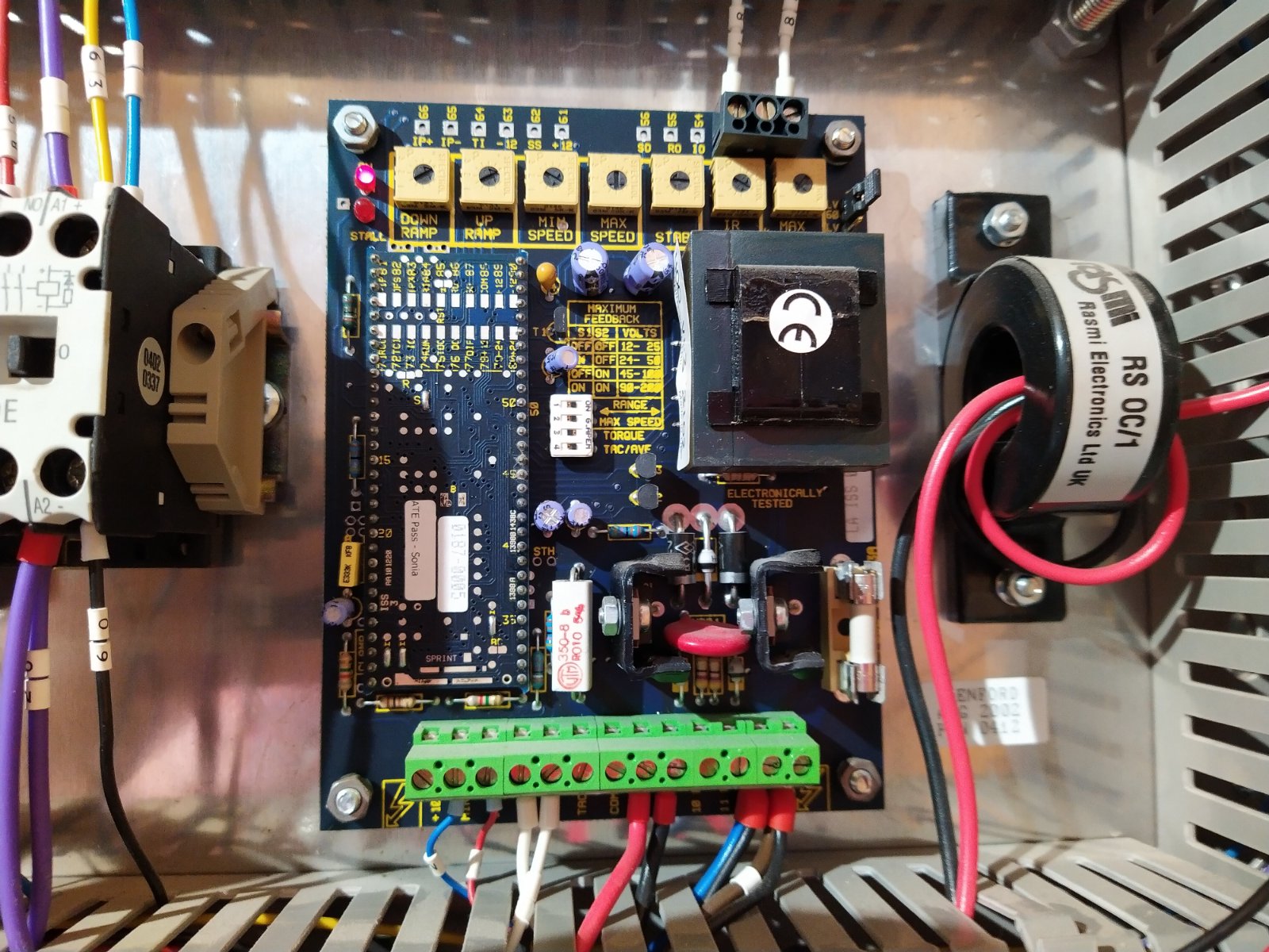

Here's how it looks
- IMG_20200726_114736.jpg (371.54 KiB) Viewed 28084 times
- IMG_20200726_114723_1.jpg (419.4 KiB) Viewed 28084 times
- IMG_20200726_112736_1.jpg (452.27 KiB) Viewed 28084 times
Re: Major Timeout Error
It all looks fine.
How are you connecting from the machine to the computer? USB - Serial Converter or straight from a serial port?

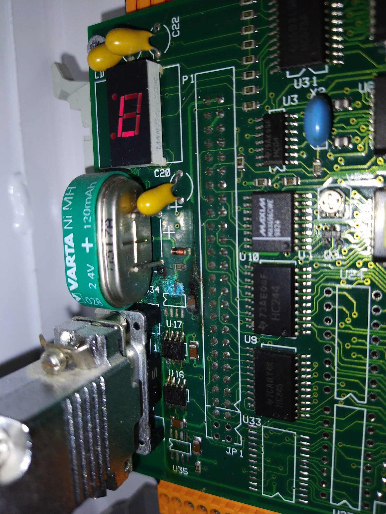

Could this be my issue?
Middle of the photo there appears to be signs of burning?
- IMG_20200726_162006.jpg (552.42 KiB) Viewed 28070 times
- Posts: 613
The leaking battery has caused issues in the past, there are many discussions on this (give it a search, these boards were used in most machines at some point. It is not needed and can be removed. I cant remember what you need to use to clean up a niMH 'spill'. You need to clean off the corrosion and nutralise the 'acid'. You may find this makes things work.
