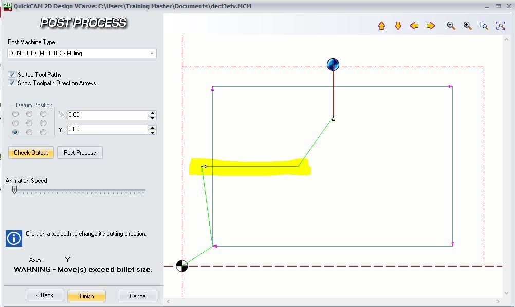

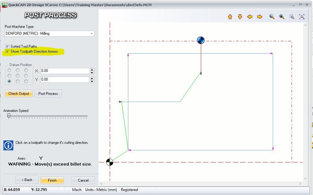

Post by Steve » Mon 16 Dec , 2019 16:43 pm
Pete,
Do you have QuickCAM 2D Design On the simulation page you can see the direction of cut.
If you click on the cut in question you can reverse the toolpath. Then postprocess
sort tool path.JPG (66.2 KiB) Viewed 15967 times
sort tool path1.JPG (59.6 KiB) Viewed 15967 times
