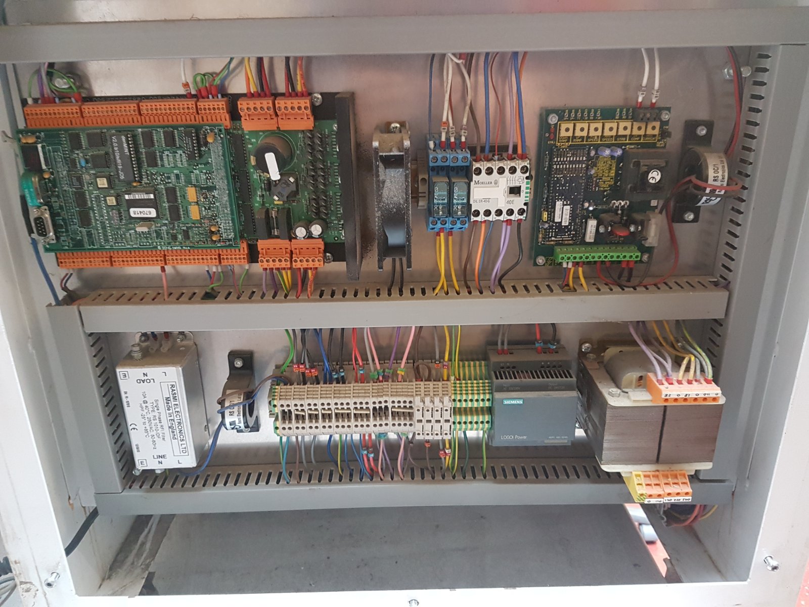

It looks as though everything is there.
Did you get the machine link cable?
You should be able to connect using EasyUprader in order to check the communications if you have the correct lead.

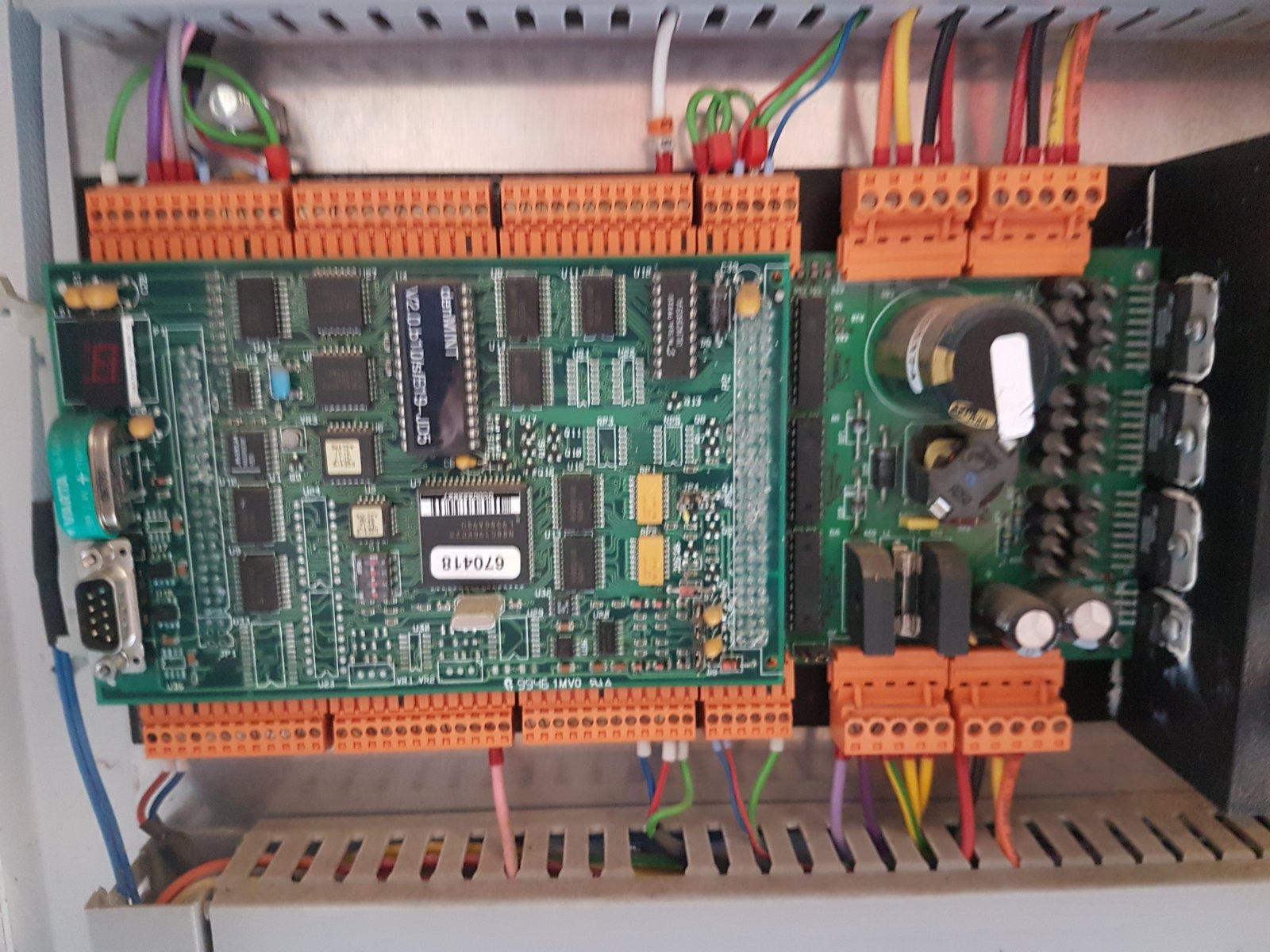

Unfortunately it looks like top board of the controller has suffered from battery leak and gone green in couple of places, one microchip just fallen off!! I try it anyway but Mach3 or Linux cnc conversion might be my only option :(

Im a bit puzzled why there is no RS232 plugged into the top board running to the outer case. It doesn't look like it has just become loose, fallen out and is hanging about either.

Hi Pete.
I have unplugged it for the photos.
BTW, I have cleaned that mess created by old leaking battery and resoldered microchip. Fingers crossed it will work.
