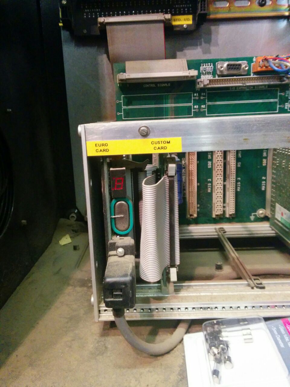

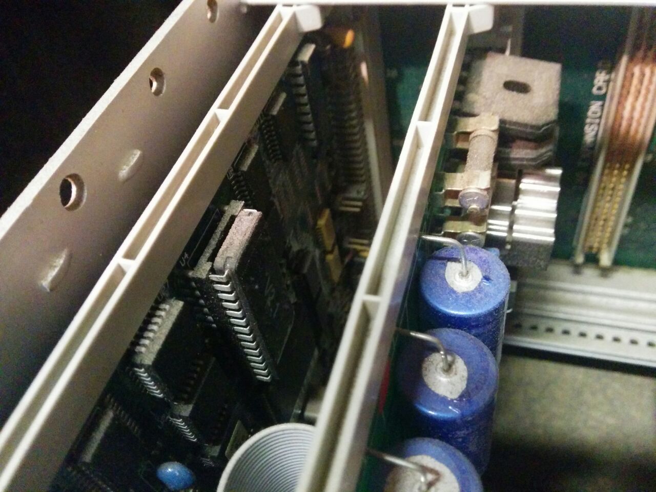

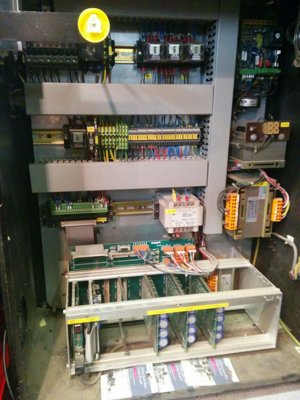

- CNC Apprentice
- Posts: 42
- Joined: Mon 05 Sep , 2016 12:27 pm
- Hardware/Software: Triac PC (1998, easychange), Mach4, Fusion 360.
NovaTurn NS, VR Turning, Fusion 360
Re: Arc Problem
Had a quick look at the machine and it seems the eeprom is v2.1
- eeprom.jpg (170.4 KiB) Viewed 36756 times
- card.jpg (154.67 KiB) Viewed 36756 times
- rack.jpg (175.55 KiB) Viewed 36756 times
Re: Arc Problem
It is a DenStep with the latest eprom fitted.
