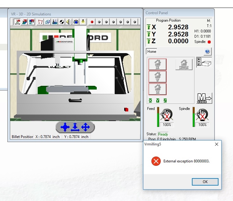

I've just tried to run VR Milling versions 5.51 and 5.61 on a Windows 10 PC. They start up OK, but as soon as I try to run a .fnc file in 2D simulation I get the error message "External exception 80000003". The program then locks up and the only way out is to start Windows Task Manager and kill it from there.

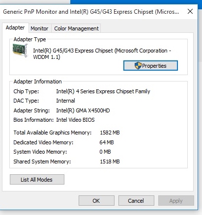

The graphics card is:-
Card: Intel(R) G45/G43 Express Chipset (Microsoft Corporation - WDDM 1.1)
Having googled this I found that only Windows XP and Windows 7 drivers are available for it and there's no intention to develop a Windows 10 driver.

With Windows 10 the program opens normally and it is possible to change settings etc. If the "VR Machine" button is clicked the machine homing window appears followed by the graphic showing the machine. Immediately after this the error message appears and the program locks up. No .fnc file needs to be opened

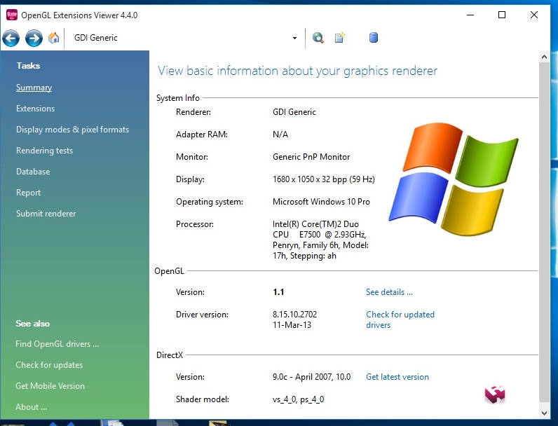

I don't think the fault is with the video card, as it worked with VR Milling until the PC's OS was upgraded from W7 to W10.
The drivers are Microsoft's own and are the latest version. Intel, who made the card, have different drivers, but these are only for W7. They can't be loaded on a W10 machine as an error is thrown up at the installation stage.
I checked my W7 PC which is currently running VR Milling correctly. That has Intel's own drivers, but as the hardware is different not much can be deduced from that.
The video card does support GL version 1.1.
