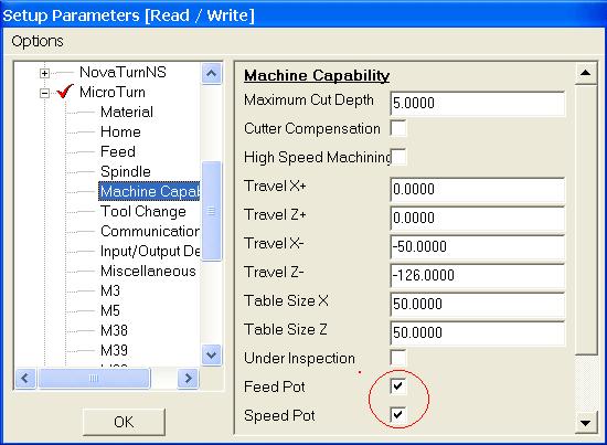

Post by bradders » Wed 08 Feb , 2012 10:44 am
If your machine has Speed and Feed Pots and you have just reinstalled VR Milling and the pots don't work, the you may have to activate the pots manually.
Feed and Speed Pots.JPG (46.13 KiB) Viewed 17398 times
