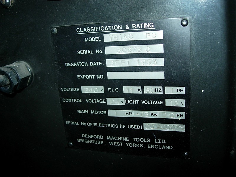

I have the denford triac pc, serial no. 30623 G, despatch date, sept 1993, serial no of electrics OC A00078, ESMINT 3.28. The machine has toolchanger. I would like to do upgrade this milling machine.

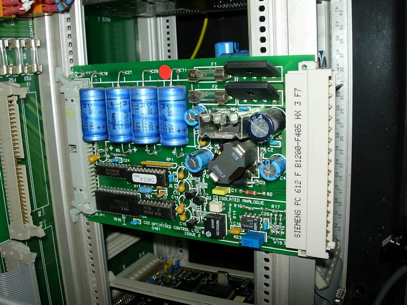

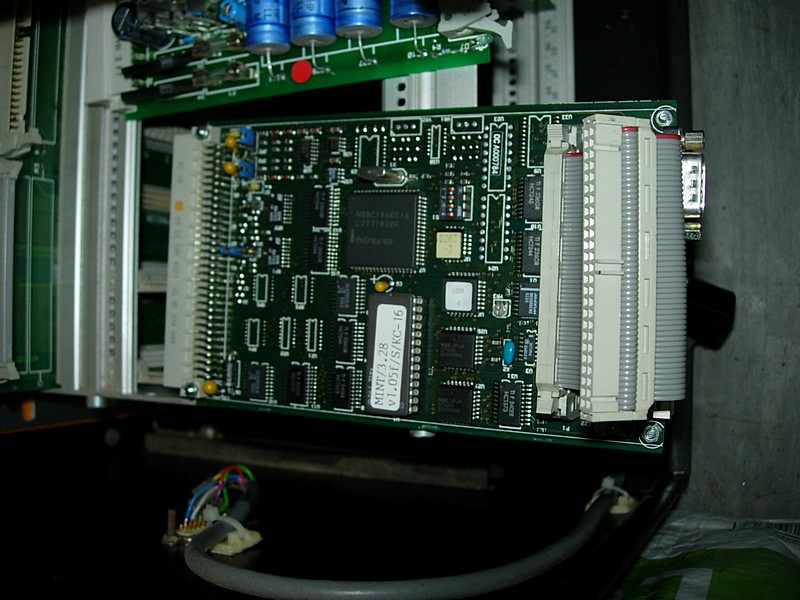

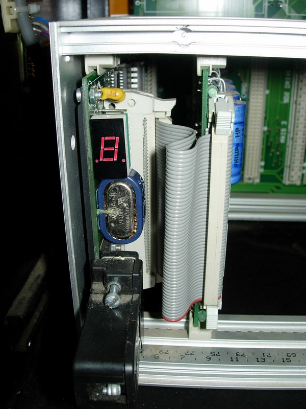

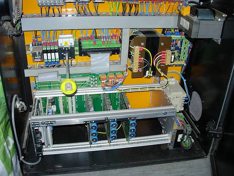

You'd have top confirm the control type - upload a photo of the electronics...don't think we would be able to offer the UG0007 upgrade for this machine. I presume due to it's age (1986) that it will be fitted with a NEE LCB3 card.

Re: Modernising a TRIAC
Hi Maciej
Yes your Triac Pc will upgrade using the UGR0007 kit.
The kit includes a rack controller card plus internal USB plug & cables & VR CNC Milling 5 software (single seat)
It would require a hole in the side of the cabinet for the USB bulk head fitting & may need the speed & feed overide pots changing to the 5 Volt supply (originally 12 volts if fitted)
