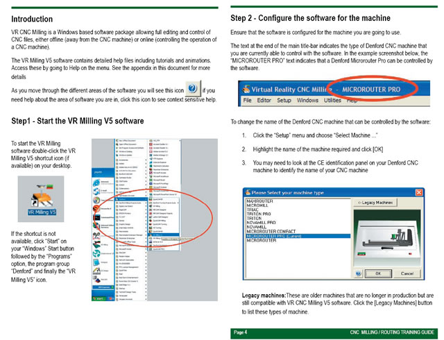

Re: Getting started with VR Milling
A good guide to getting started with v5 VR Milling:
V5 CNC Milling_Routing.jpg (79.02 KiB) Viewed 26107 times
V5 CNC Milling_Routing.pdf
(5.22 MiB) Downloaded 6038 times
