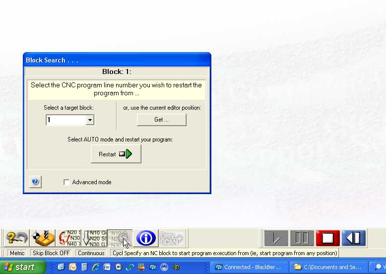

Block restart is available in VR Milling 5.
Simply click on the Button in the bottom left of the screen (next to the blue info Button)
The block number you want to start from is entered and the machine will then run requesting toolchanges and spindle speed changes. It then drives to the X and Y position before moving to the z position.
You are then asked if you want to continue the program.
Note. If you are going to stop a program first turn the turbo off so each line of code is run in turn and then stop the program. This will then record the exact line you are stopping at.
If you stop the program with the turbo on there could be as many as 80 lines in the move buffer that are lost so you would have to start say 100 lines earlier in the program.

- block restart.jpg (38.75 KiB) Viewed 6203 times

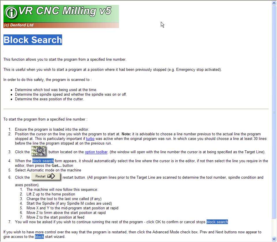

Go to help in VR Milling and search for Block Search.
- help.jpg (100.4 KiB) Viewed 6202 times
