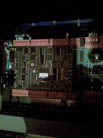

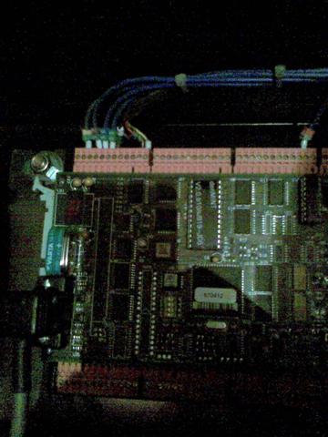

OK folks, assuming EPROM means a chip... I've checked the main board and this is the item I have it is a denmint V2.0 b10/s/b19-jd5. Pics attached.
Looks like its been upgraded as I have what looks like an earlier version chip V1.6? in my bits n bobs box that came with the novamill, ESMINT 3.28 V1.6H/S-JD5. So looks like I'm at V2.0 not V2.1, so is the upgrade a freebe or how much is it gonna cost, do i need it for running v2.31 of VR milling?
Thoughts...
PS thanks for the help so far...
Barry
Re: Novamill and Vr milling 2.31
"DenMINT V2.0.b10/s/B19-JD5" - The early Version for running VR Milling Ver2 superceded by Ver 2.1b6
Ver 2.0 EPROM will work fine. v2.1b6 was updated to improve RS232 error checking, so if the cable is poor quality or in an electrically noisy environment then v2.1 was less likely to suffer from data corruption.
v2.0 EPROM suffered from a very rare data corruption which went undetected and occasionally led to a random machine move within a program.
While it will be worth trying to get a v2.1 EPROM off bradders, I don't think this would cause the original symptoms you had when upgrading to v2.31 VR Milling
I think I'd get used to whatever is working for the moment - bearing in mind that not all version upgrades of the VR software had important fixes or features...many were simply because we had added new machine or controller types which wouldn't effect the novamill.
