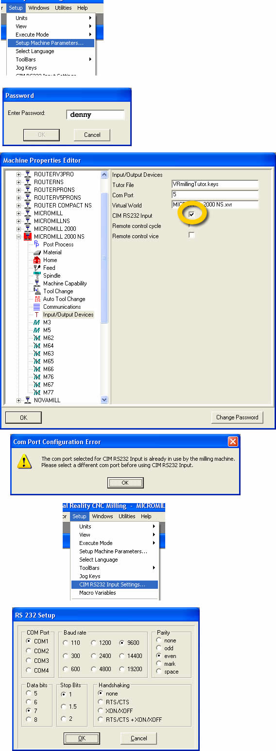

VR Milling v2 and v5 has the ability to pick a .fnc program and run it from remote commands sent via an RS232 interface.
Setup the software by following the screenshots below:
Setup the 'CIM' comm port to match the other PC comms settings, eg Com 2: 9600 baud, even parity, 7 data bits, 1 stop bit
Then send $$MACHINE FROM testprogram.fnc
If the program is found and executed, then the text EXEC will be sent back via RS232

Open a .fnc file in the correct directory 1st, so the software knows where to look for them and keep the software into Auto mode.
Set up VR Milling to run .fnc from external RS232 commands
- SettingUpCIMRS232.jpg (118.17 KiB) Viewed 5638 times
