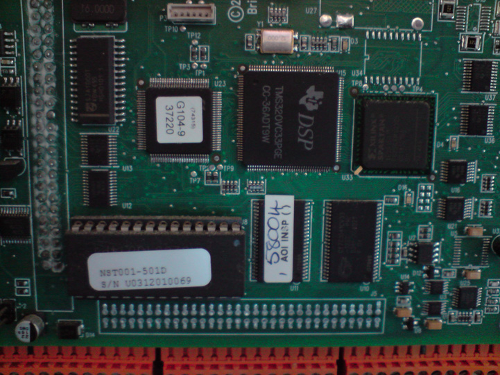

Can you post pictures or read the label of the EPROM fitted close to the right of the 7-segment LED display inside the electrical boxes ?

Re: Vr Milling slow feed rate and random cuts.
Mocrorouter compact serial number is E00482/3 if that is also any help
- microrouter compact.jpg (223.87 KiB) Viewed 5668 times
Ahh right - this is a different issue that we've had in the past - this is a firmware update you need via EasyUpgrade (not a new EPROM like I suspected):
