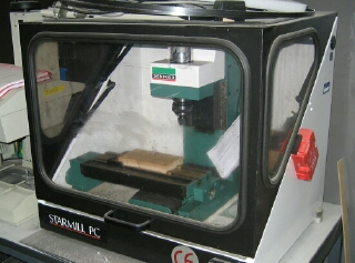

I have acquired a very dusty but hardly used starmill. How can I get hold of a manual and software? Is there a standard parts list for the starmill as supplied to schools describing the cables, desktop tutor etc.?
Does anyone have a copy desktop tutor keyboard overlay?
I would appreciate some photographs to confirm which model I have.
Any help welcomed.

My Starmill (starmill pc) is a newer model. Picture attached.
Any further detail welcomed.

Post by Martin » Wed 20 May , 2009 22:25 pm
What is the version number of the Eprom on the main control card inside the black electrical cabinet?
It`s the card with the 7 segement LED in the top left & all the orange connectors.

The version number is 2.1 and the information on the outer case plate is
as follows:
Serial number 50119 - 1
Date Feb 1995
Tom
I have downloaded the various drivers etc. from the website and will try to connect to a pc this weekend.
Post by Martin » Thu 21 May , 2009 21:59 pm
Version 2.1 is a VRMilling Eprom.
The normal software for this would be VRMilling Ver2.31 which you can download from the Denford Website. However it will require a software licence to enable it. Did the floppy disc with the VRMilling Licence come with the machine?
