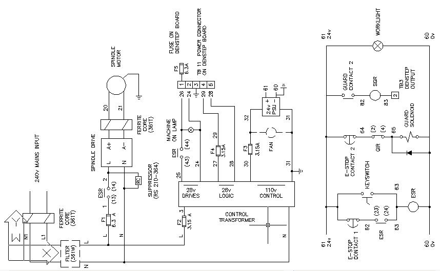

Post by bradders » Thu 23 Apr , 2009 15:08 pm
Does the Red light next to the Key switch illuminate? If not, then the Emergency Stop Relay (ESR) is not latching in. It could therefore be a faulty Contact 1 on the rear of the Emergency Stop button

Post by gslice » Thu 23 Apr , 2009 15:49 pm
Well, the red light has apparently been burned out for a while and not replaced so I really can't tell.
