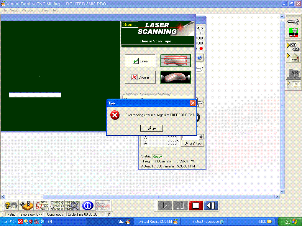

Post by bradders » Thu 22 Jan , 2009 12:10 pm
Laser Scanner, CBERCODE.TXT error
Laser Scanner error.GIF (89.46 KiB) Viewed 6114 times
Post by bradders » Thu 22 Jan , 2009 12:13 pm
Looks like its to do with the c:\mcc folder being missing or they haven’t installed easyscan drivers off the CD
In c:\mcc there should be:
CB.CFG
cbercode.txt
cbw32.dll
ULPROPS.TXT

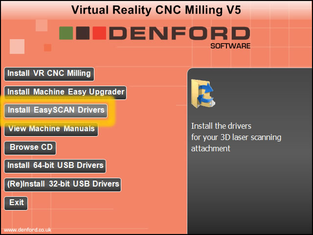

Post by Denford Admin » Wed 15 Sep , 2010 15:44 pm
We've just had this problem here.
Even if you believe the easyscan driver has been installed from the VR MIlling 5 CD menu, double check that the folder C:\MCC exists.
If not, then try installing the easyscan drivers again, if that still doesn't work then copy the MCC folder from the V5 CD into the root of c:\
