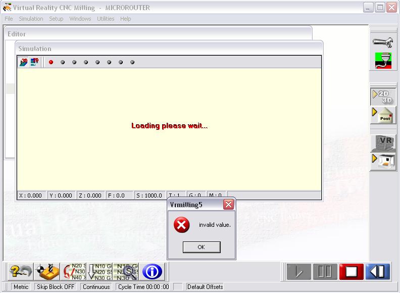

Currently running VR CNC Milling v5 but for any user (student and admins) using the program when you click on the 'Convert to 3D' button a popup box appears saying 'Invalid value' (see attachment)
Then when you click 'OK' on the message another popup instantly appears and the only way to then close the application down is to end task via Task Manager.
Invalid Value Error
Milling error.JPG (53.69 KiB) Viewed 9880 times

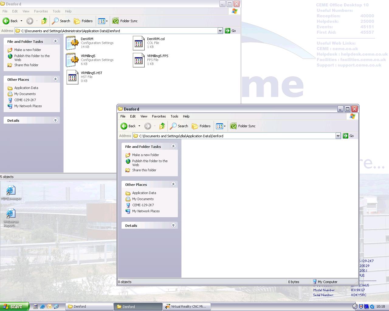

When Denford is run using a local administrator accounts the program works fine. However when you run the program as a domain user or domain administrator you get the 'Invalid Value' error come up.
After some investigation work we found that the Application Data\Denford folder only populated when using the local admin account and not when using a domain account as you can see in the attachment.

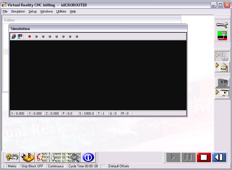

If i try lowering the Hardware acceleration as suggested i got a black screen in the simulation rather than the 'Invalid value' (see attachment).
Application Data\Denford only populating with a local account
Application Data.JPG (135.78 KiB) Viewed 9844 times
Black screen when lowering Hardware Acceleration
Black Screen.JPG (55.89 KiB) Viewed 9844 times

Post by Denford Admin » Mon 01 Mar , 2010 17:17 pm
Another customer is seeing the "invalid value" error and it seems to be related to the installation and who is logged in at the time:
In versions up to and including v5.31, the 2D/3D simulation will cause errors if DenVRM.ini is missing or corrupt.
This issue has been addressed in 5.32, but has not been released yet (1st March 2010)
When the software is installed for the users, the file DenVRM.ini must exist in:
C:\Documents and Settings\[USERNAME]\Application Data\Denford
The file on the CD could be copied across from the folder: D:\VRMilling5\Application Data\Denford
