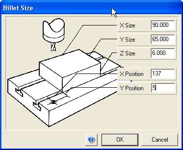

I have tested the file and it worked OK once I had positioned the billet correctly in the travel.
To move the billet on the bed of the virtual machine press shift then drag the part with the left mouse button.
At the end you get the box to change billet and datum position.
Try with the values shown
- screen1.jpg (20.55 KiB) Viewed 7943 times
