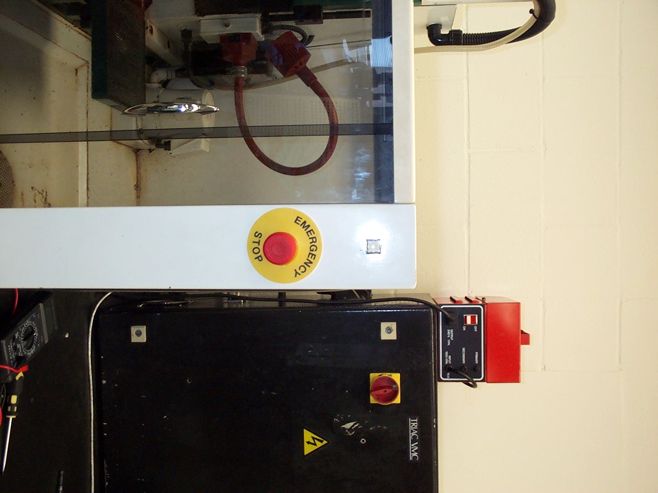

Reasseble the card rack. so thats good. Where is the big green start button.
Post by Denford Admin » Mon 27 Apr , 2009 14:50 pm
I thought these machines have a drives on button on the front panel by the override pots and overtravel override switch.
If you can't find one, then I'm thinking of another machine :?

I'll get some over all pictures.
trident
Posts: 22
Joined: Thu 05 Mar , 2009 9:31 am
Post by trident » Mon 27 Apr , 2009 20:13 pm
Hopefully this will help some I sent my workstudy to get the picture.
Post by Denford Admin » Tue 28 Apr , 2009 9:02 am
Sorry if this is a silly question, but you have checked all the terminal fuses located at the top left of the electrical box ? You unscrew the black cap in the middle of them...at a guess F1 - F4 would be there
Have you got sufficient air pressure ?
There's a possibility e stop could look ok to the software, even if it isn't to the drives, because of air pressure...
Oh and I was thinking of something else - it was a Meteor lathe that had the drive on button :oops:
