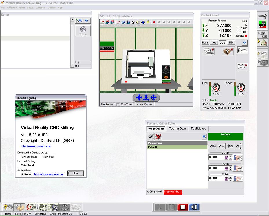

In VRM5, using the Virtual Machine (C1000 Pro), why would the program position be other than 0,0,0, upon a successful home, with work offsets of 0,0,0?
I open a blank editor window, connect to VR machine, and home.
I open my offsets window, ensuring they are all 0.000, and I view my program position to be:
377.000,-60.000,12.167.
I have not got any tooling offsets.
See screenshot:
Screeshot

You probably have Auto Datum turned on in the VR menu (it appears in the main menu when you highlight the VR window)
Auto Datum sets the datum positions according to the position of the VR billet on the table (btw, you can hold down shift, and leftclick to drag the vr billet around the table)
